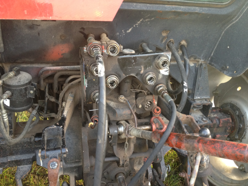

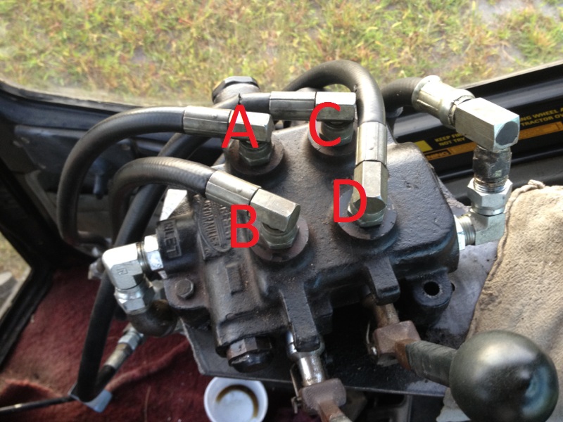

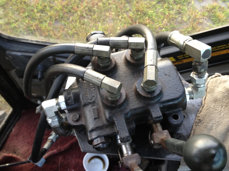

His is going to be long so bear with me. I have a Case IH 885 w/cab that I bought. It was a county mowing tractor and has one factory remote. That decided they need 4 remotes and put a three spool valve in the cab (dumb in my opinion). I have a hydro swing windrower that I am trying to run that needs two remotes. When I hooked up the windrower and tried to swing it the pressure relief valve would bypass on the added valve. It was non adjustable and set at 1750psi. That was first cutting of hay and I said screw it and just used my old tractor. Now I just picked up some more acres and it is hot as **** out and I want to cut in ac. So I have an old loader valve that I put in place of the three spool. Now when I try to swing it will only swing one way. If I switch the hoses it will only swing the other way. It does this on both spools. If I hook it up to the factory vale it works fine but someone must have decided that they didn't want that valve and they cut the handle off under the cab (again dumb in my opinion). I have to crawl under the tractor to get it to work. I am stumped and I prob will just fab up a handle real quick so I can cut. I would like to figure it out what is wrong but I already have two factory valves that I am going to add this fall when I have more time to build the controls for them because I cannot find them anywhere. Sorry for the extremely long post but any help is appreciated. Thanks.

Do you have a picture of this loader valve as it sits? And/or a make/model?
I have some ideas, but I dont want to mislead you.

Here is a picture of the loader valve in the cab and the outlets at the back. The loader valve is plumbed before the factory valve.

Just to confirm, you are connecting to the lines which lead to A and B, or C and D (as seen in the picture above) not any other combination?

I was putting an arbitrary label on the ports to distinguish them, not trying to find the manufacturer's markings. Looking at http://www.surpluscenter.com/Instruct/I9-7862-F.pdf the ports are in line with the handle (ie: my arbitrary labels of A/B or C/D for work port pairs match with the cylinder connections shown).
Aaron Z
Aaron Z
That is the way I have them hooked up. I will have to double check and make sure they are not switched.

The pic of the back of the tractor of the couplers how are you reading or how they match each other? The 2 hoses that are hooked up I would say that is not a match.

I read them by following the hoses but for the factory setup there are colored stickers on each side that match the color of knob on the handle in the cab. It is a little different how they hook up so far apart, but that bottom set is the only ones that work correctly.
