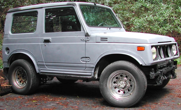

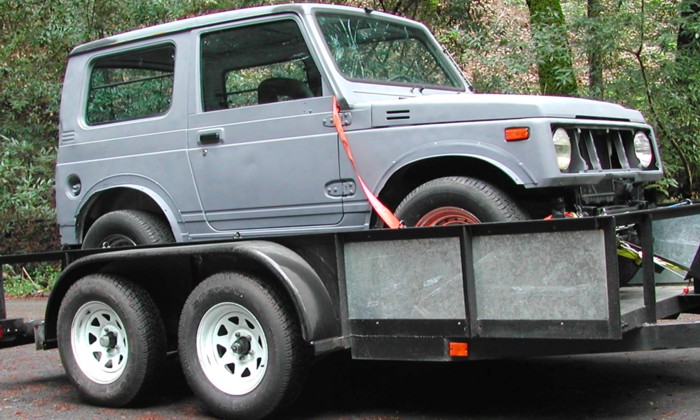

Well, not completely homemade; I started with a Suzuki Samurai.
Moving dirt around with your tractor, one loader bite at a time can be pretty
inefficient and frustrating, esp when you need to move the dirt more than
100 feet or so. 500 feet, and you REALLY want a dumptruck.
So.....I have always wanted a small utility vehicle that could move a ton
of dirt or rocks at a time, easily. That rules out your ubiquitous Gator, Mule,
Rhino, or RTV. Those factory side-by-sides are quite expensive, too.
Enter the Suzuki Samurai, a 4x4 small jeep that features short wheelbase,
fully-boxed frame, and readily available repair parts. You can land one of
these for $500, with a little patience and a trailer.

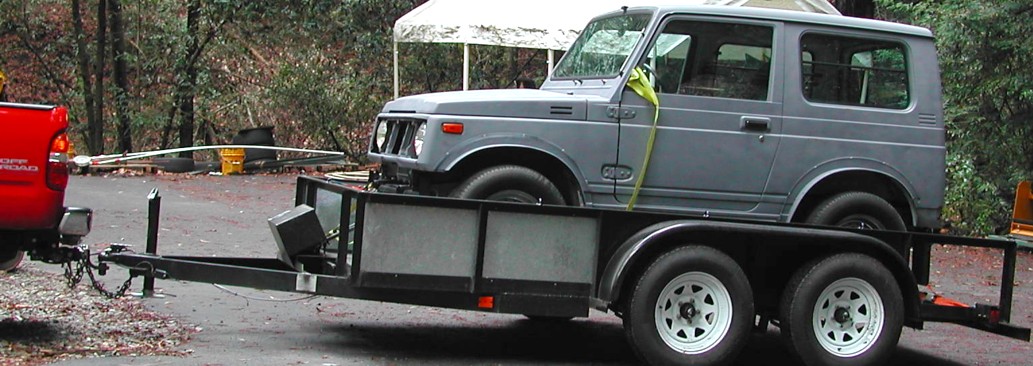

So, I got me an 88 "tintop" 1.3L 5sp a few years ago. Engine and tranny needing a
bit of work, but no frame rust, good compression, and the front hubs not
frozen. (I did get a "free" 86 AMC Jeep Wrangler before this, but it had only
a partially-boxed frame, and it was bigger, with a 6 cyl motor. Got rid of it.)
An even better find would have been an automatic Sidekick/Tracker with the
1600cc FI engine.
Photos show my acquisition, hauled 25 mi to my property.

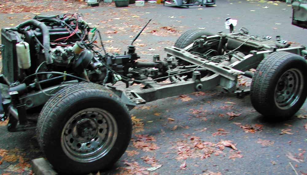

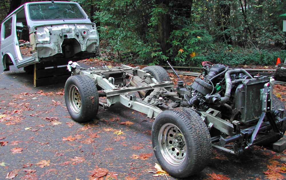

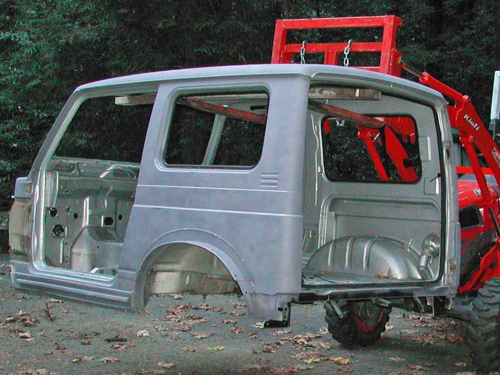

Next, I removed the body, which I scrapped. I sold a bunch of the parts on Craigs,
recouping most of my $500 investment.

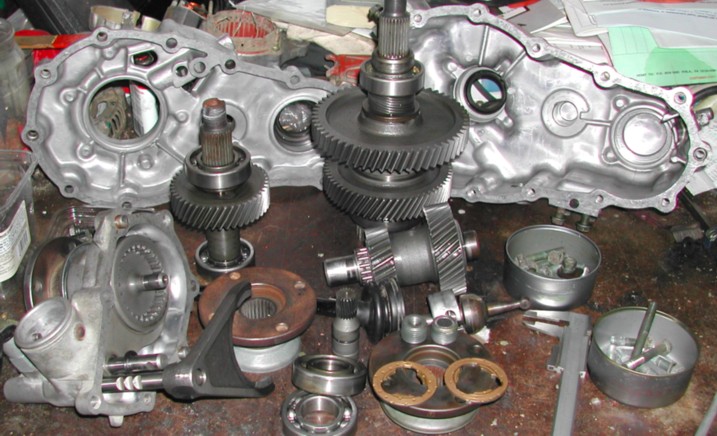

I could get the engine to run (poorly), but I quickly found that the clutch was frozen,
so the tranny would have to come out.
This vehicle features a separate transmission and transfer case. Tiny little suckers,
and very easy to lift out from above with the body off. No jacks or lifts at all.
The boot on top of the transfer case was missing, so I wanted to open it up to make
sure all was clean in there.
After peeling off the stuck-on clutch disk, I rebuilt both the tranny and transfer, the
easiest I have ever experienced. Gears and bearings were all good. It looks like
an optional PTO shaft could be substituted for one of the transfer case shafts. A
PTO would be fantastic, since I planned to somehow run a hydraulic pump.

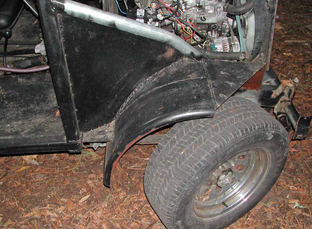

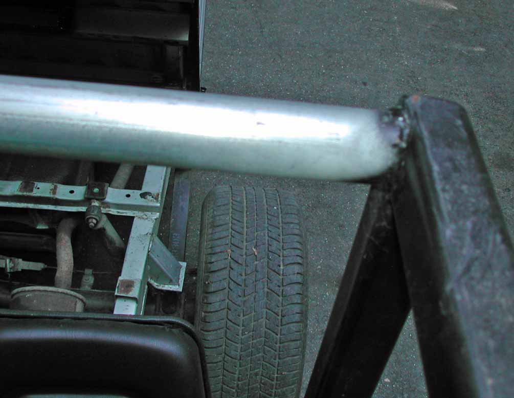

I took some 0.08" steel plate I had and welded it to the frame tabs to make a
floor, and bulit a roll cage of some square tubing, plus some IMC conduit. Front
fenders are made of the same plate, plus some pre-formed trailer fenders I bought.
A steel plate firewall isolates the engine compartment.

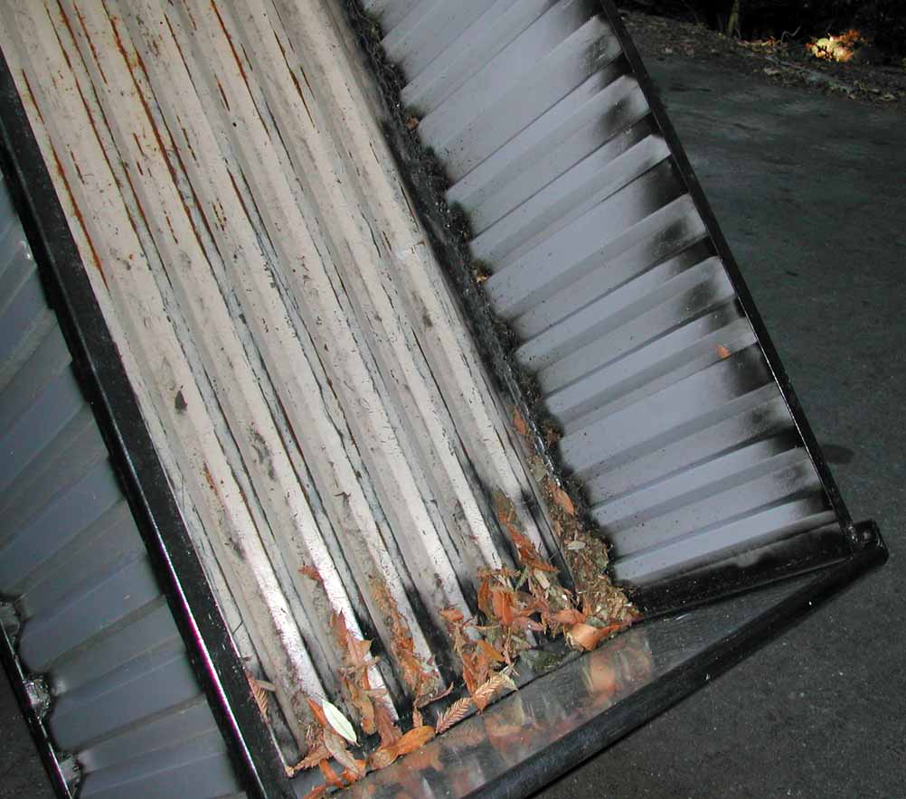

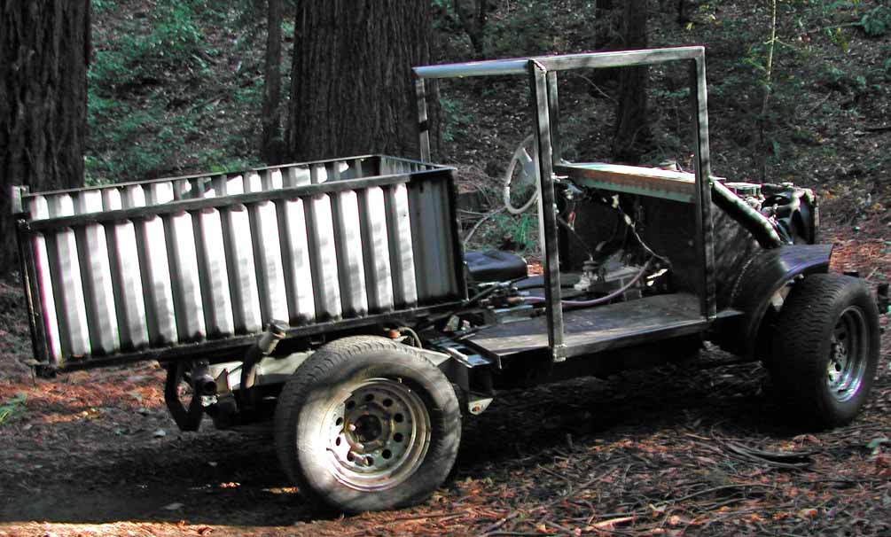

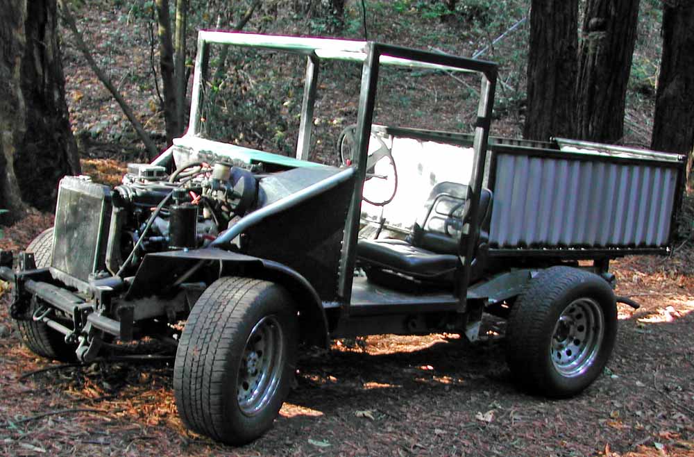

And here it is. "FrankenZuk", if that name had not already been taken.
I had a big dilemma: The frame is really short, and the engine takes up a lot of it.
I really should toss the engine and go with a more efficient cabover design so the domp
box could be large enough. That would use a low-mounted engine, not the tall motor
in the stock truck. Too much work for this one, I decided.
So, I went with a small 5x3 dump box. Narrower than the wheel spacing so it can sit
lower, and overhanging the rear of the frame. The box is formed from the bottom of the
bed from an 88 Ranger (another freebie), and some corrugated steel roofing/siding I had.
Edges are finished with angle iron. The tailgate is a top-mounted unit to add strength
to the sides.
Without any load, the Sami is essentially undrivable on any slope in 2WD, since there
is little weight over the rear wheels (RENZE), and my tires are crappy.
