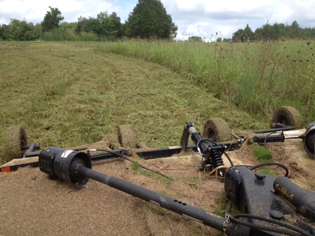

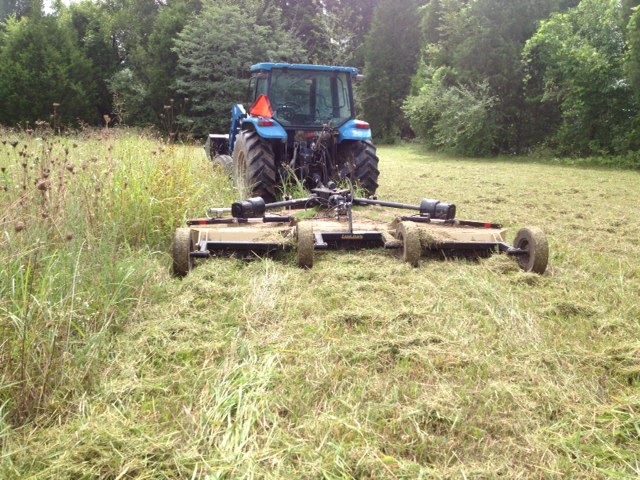

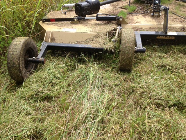

Hey Soundguy, I have something better. The mower is a Landpride RC2512, if you go to their web page and look under rotary cutters you will find the RC2512 and it has the parts manual in pdf format. This mower I bought it new and this is my 3rd year with it. Started having the problems with it at the end of the grass season during the 1st year. I have taken it to two dealers and they have inspected saying nothing is wrong. They even removed the gear box covers. I have connected it to another tactor and it cuts fine like it should. I will go over it again just in case I did miss something and look for those areas that you mention. Thanks for the input cause I am taking all advice to heart. I am ceratinly puzzled about this.

ok.. on just the first page.. i see that the main driveline is cat 4 constant velocity, that hits a 3 head box like my jd mower.. then it uses cat 3 drivelines to each other head with mower spindles. and THOSE have slip clutches...
that's where i'd look.... the slip clutch on the spindle that is missbehaving.
also make sure it's pto shaft has not spun inside itself... nor the 2 yoke ends or the connection to and from the slip clutch.. which could be either splined or smooth and bolted.

I marked the clutches and I have checked all of the pto axles and everything looks good. I used the mower on Monday and I have found that it is streaking grass on both sides. I got into some really tall grass, low speed, running at 2000 rpms and the same results. Put the mower through 2 hours of operation. Checked all the marks and nothing has moved. It appears that I am losing some pto power? What would cause that? I have replaced pto clutches, checked hydraulic pressure. What else can I check?
   / A HARD PTO PROBLEM TO SOLVE #19
DUDE! if one side cuts fine.. you are NOT loosing PTO POWER!
I'd check to see if you are running the grass down and that is where it is streaking.,

Tip it on its side or end and show us a pic of the underside of this mower. Also a top view. Let's take a look ...
