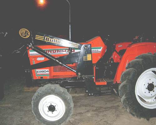

I got this idea that for the sake of a compact or mini or small or how about to put it simply anything under 4 tons, that a TLB is a better choice over a backhoe loader.
Now I had been posting a little about this recently so if you encounter my others, repeat yourself here as I hope to stir up the.
I am considering what I think you all call a 35 hp "grey market" tractor. (see the atachment now) price and weight are a factor to me. SO IS Loading and backhoeing.
It is being said to me that a TLB cant use its FEL to full capacity with a backhoe attached. What !?
So the deal is pending wether a fabricated subframe can make this dog hunt.
I dont get it, please explain this to me. Why does it seem to me to look like a duck and fly like a chicken? I mean I want to dig the. with the FEL and if need be turn around and use the BH to clear they way for the FEL to turn around and dig somemore. What is the diference between a mini backhoe loader and a TBL when it comes to digging with the loader.
Does a LOader bucket dig in either case ? Does the term LOADER bucket mean to dig with or just load ?
But again, if i dig with the backhoe on a tractor they tell me I cant turn around and remove the loose earth else I risk breaking the tractor in half the way I did my Jinma. Basically I am talking about driving into the ground they way you would to dig a basment or grading.
To recap the Jinma, I got a refund because it failed many times under warranty up to and including when I snapped it in half, because the fully loaded FEL free fell as the control valve was inferior. Come to find out, everybody operates them this way ! The heavier the load the more touchy the control ! shocking.. Any way, I just want to know what is going on in evryones head about now on these TLB and what does it do compared to a mini or compact backhoe loader like an Allmand bros, jcb mini, terrimite, whatever else.

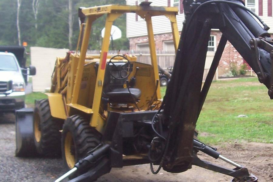

I have been giving this way too much thought as I embark on spending what little bit of money I can spare. A fool and his money. I can justify a full size 8 ton backhoe loader and I sure cant get the best money can buy mini. So I am looking for the compromise. It seems to be a HD TLB But the more I think about digging with the FEL and Lifting withe the FEL, I wonder if I am expecting too much. They say it can lift just under 1400 lbs. they tell me its breakout force and such, why do I feel like I am still going to break it ? I've learned the hard way the difference in metals. Torque and towing. I even learned hoe to how. /forums/images/graemlins/smirk.gif I just don't know what came first the tractor or the backhoe.

Well, I'm going to attempt a reply with my own thoughts based on several years experience selling compact gray market tractors, upfitting them with loaders and back hoes and talking to people daily needing this type of equipment.
I think that for what you're needing to do, or wanting to do (dig a basement) you're going to damage that tractor. Compacts with loaders are great "pushers" and poor diggers.
The "break out force" of the loader is not the lift capacity of the loader, and as you now know, a rapidly decending bucket of dirt stopped just above the ground will "shock" the tractor, often with catastrophic results.
I am of the opinion , judging by the type of service repairs I see, that if a customer has been told the newly installed loader on their tractor has a lift capacity of 680lbs, they'll try to lift 1900 with it. Or they'll lift something "off centre" twisting the tractor or loader frame.
I see way too many bent frames, bent hydraulic cylinders, buckets warped in the middle etc, from inexperienced or gung ho operators using their equipment well beyond the
designed limitations of it. And I only sell/service gray market product!
All these gray market tractors regardless of manufacture, were made to rototill. That's it. And on soft, flat, sandy soil at that! No loaders, no mowers, no back hoes. Doesn't mean they won't or can't do anything else. Just means that a certain degree of common sense must be used in operating the tractor and the equipment hooked up to it.
May also mean that a full sub frame be utilized, as well as ballasting and installation of a ROPS.

I will try to be brief and straight to the point. The front end loader is a remarkable scooping device. It will dig some, but you will be hard pressed to put the bucket down in to virgin soil and fill the bucket. You will either spin the tires or kill the engine. A tooth bar will make it dig better but that does not change the fact that it is a front end loader and not a front end digger. I have an area of rich loose top soil that I can dig into with my 32 hp Deere and fill the bucket each time. I can move 10 yards over and and I am lucky to get half of the bucket filled. It is just the nature of the beast.
A true, Tractor Loader Backhoe is different than a compact tractor that has had a loader and backhoe added to it. Take a close look at a true TLB, everything is built heavier and stronger.
Now for my opinion of the tractor you have pictured. I have had 3 or 4 Hinomoto 2304s. I love those tractors. However 2 of them suffered broken gears in the front axle from over aggressive front end loader work. I realize the one pictured is a 2804, but be careful anyway.
