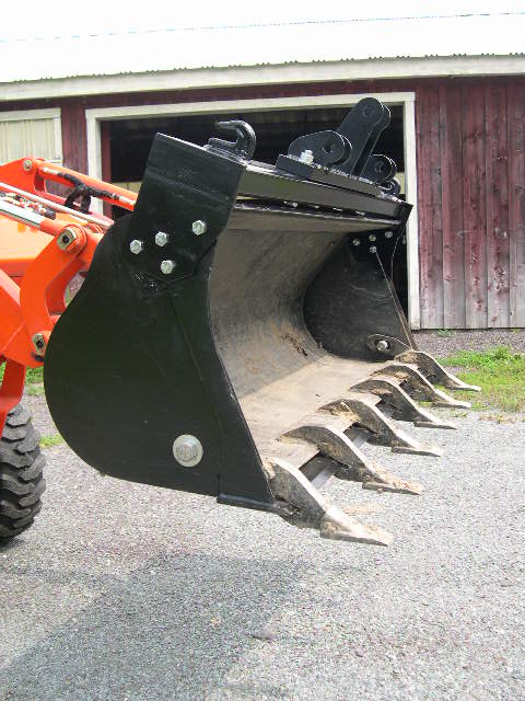

When last I posted, I was a bit dismayed by the fact that the grapple did not close all the way. This of course required some reengineering, something we non-fabricators are not known for. So I followed David Greene and PineRidge’s suggestion to rotate the tube forward. This worked and all is now well.
However, for those fabrication challenged folks like me, I would suggest following the procedures I have read here in others posts on this subject, the first time through. It will save you a lot of work.
Tack weld the pieces and then test as you go. If I were to do it again I would drill the cross brace and bolt the grapple mount to it. Then I would tack weld the end plates to the cross brace. Place the entire assembly on the bucket and drill one bolt hole in each side piece at the front top and bolt to the bucket. Mount the grapple and cylinder to it. Then, with the cylinder extended, tip the cross brace until the grapple touches the bottom of the bucket. Clamp and drill the remaining holes in the sides. After you are sure it works remove and weld it permanently
If you are like me, a beginning welder, you will find that the one weld that will be stronger than anything you have ever welded before is the one you have to take apart.
So here is the reengineered mount. Note the tip toward the front and the extended side plates. I had to add two inches to the bottoms to have enough to bolt on to the bucket.

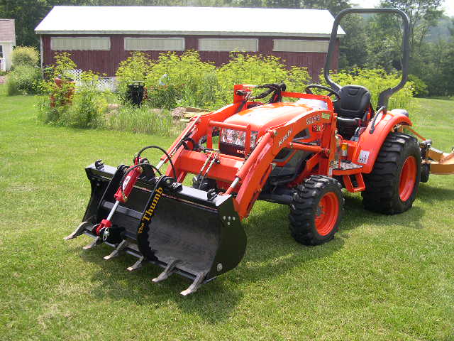

The remounted grapple open.

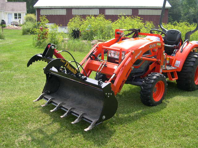

The remounted grapple closed.

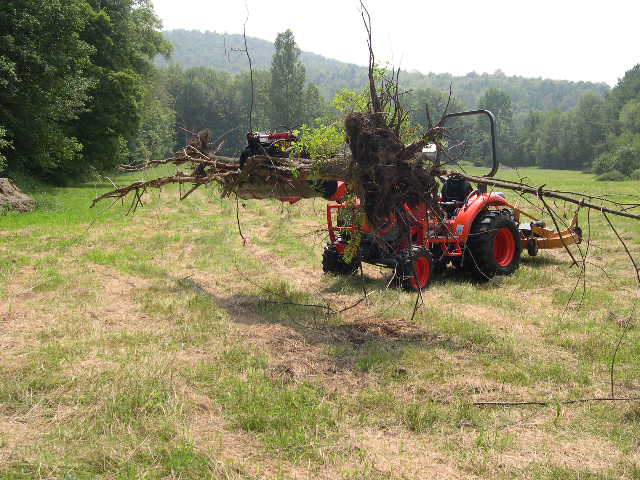

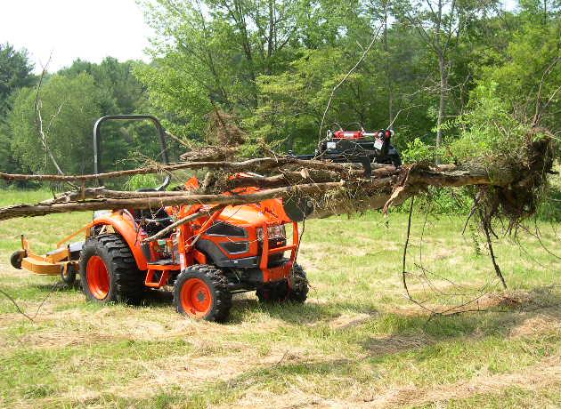

And finally, the grapple at work.

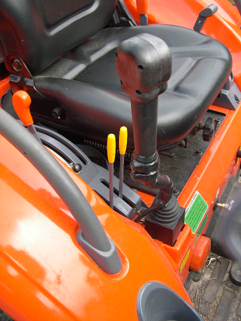

Here is another shot of the joystick handle from WR Long I used. This handle makes using the grapple very easy.
I used ¾” wire loom from Radio Shack on the joystick because I wanted the wire protected. I tried tying the wire loom off with wire ties but did not like the looks of it. I ended up wrapping it with commercial black tape. I like the looks much better.
I slid a piece of ½” under the ¾” at the bottom of the joystick rod and ran it through a ½” hole I drilled behind the joystick boot. Using the small wire loom included in the kit from WR Long I covered the wire under the tractor and ran it inside the ½” loom for about 2 inches. I trapped it with a wire tie pulled tight. All wiring is enclosed in wire loom to protect it.
Note: I lengthened the remote handles 4” to make easier to control. Now I can feather the remote cylinders. Before they very hard to use and wanted to jump into the detents almost every time
