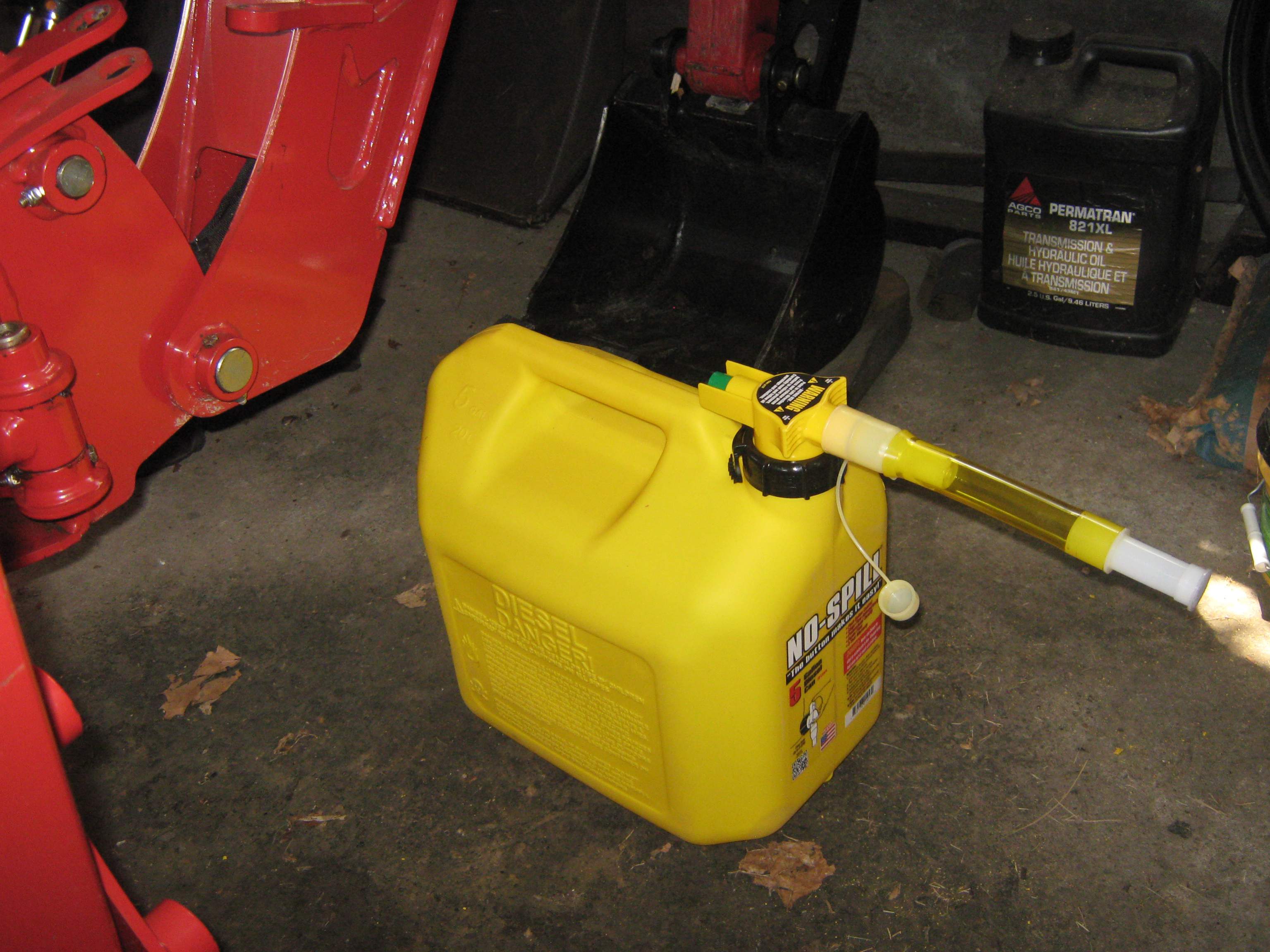

Topping it up with fuel wasn't much fun - the handle in front of the filler wasn't a great design idea. Are most people filling them from Jerry cans? I guess it gets easier with practice, but I managed to spill fuel everywhere and had it splash on the seat and tyre to my dismay....

Do you have a spout/nozzle on the jerry can? That will make a big difference in fueling. A funnel might help as well.

What I do when filling up is I lift the seat up over steering wheel and use my 5gallon jug to fill tank. I start the pour from behind and then just let sit on filler neck filling up and walk away for 5 mins.
