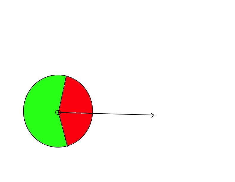

Seems lots of people believe a tree will go the same direction as the rope. It can really go any angle up to nearly 90 degrees from the rope. The rope only keeps it from going into a semicircle away from the rope direction.
Bruce

Good point. One line of pull may not be enough, pulling or anchored at two directions working together would be better.
If you did a half way decent hinge cutting job that’s not likely. I’ve watched tree guys quite a bit and they’ve always used one line. They all always de limb the trees which makes its path more predictable.

I would never consider using rope to pull a tree. To much stretch even in the non-stretch type.
It's cable and chain for me. I've got a 60 foot length of 1/2 inch cable with eyes at each end, and 80 plus feet of 1/2 inch chain (4X20)
I don't have any 140 foot tall trees. ;-)
