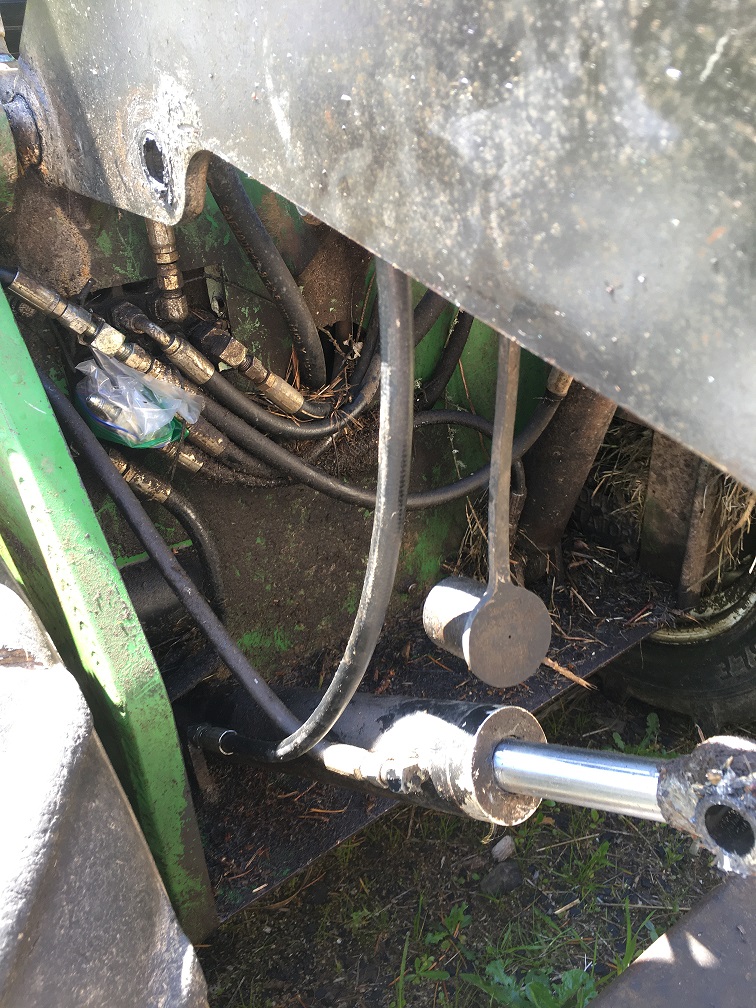

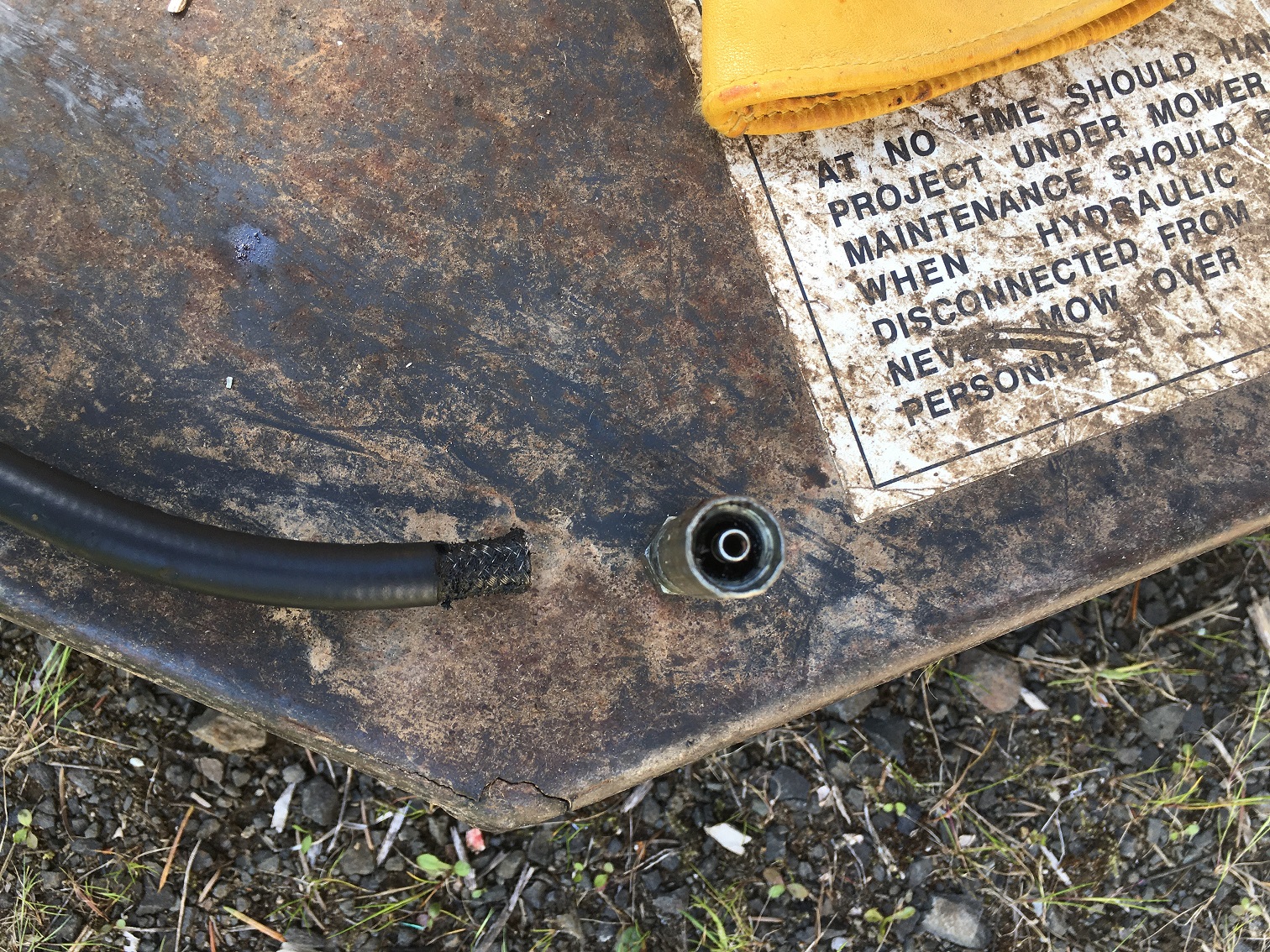

Popped the end off of a hydraulic line.Thank goodness i had supervision.
It was a short hose. In the first picture, you can see the plastic bag, where one end goes, and then the bottom of the ram, where I have my bleeder hose attached to the bottom connection. The second picture is self explanatory. The third and fourth, are of my supervisor. Tomorrow, i'll attach the replacement hose.

   / A Catastrophe of sorts.
I got it running today. Got a hose made in town, much more then i remembered the last time i got a bigger longer one made, several years ago. Much thicker then that on the PT so had them put a right angle on one end. No way i would have been able to bend this one into the shame shape as the one that it replaced. Put a few hours on it, no leak so far.
