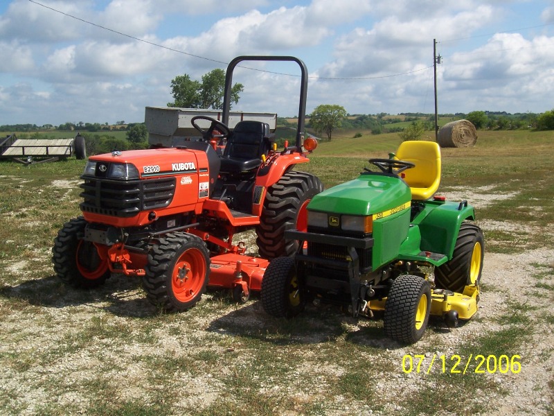

I had always owned John Deere garden tractor size mowers, JD140, JD322 and then a JD455 with 54" deck. I decided I wanted a 4wd bigger tractor so I bought a Kubota B2910 with 60" deck. The wife would run the JD455 in the tight spots with low hanging limbs, I'd run the Kubota on the more open spots and steep slopes. I thought it was a great combination. I had $15K in both machines. Then my shop burned and I started over. I bought a JD 2210 with 62" deck to mow with and a L4400 w/FEL for tractor work.
A couple comments that might only apply to me.
The JDs all have suspended decks. The Kubota B2910 had a ground contact deck. The Kubota did a lot better job of mowing than the JDs.
The B Kubota was a bit too big. Couldn't get under trees very well which resulted in more Weed Eater time. Kinda like the situation TripleR described.
The JD2210 (comparable to the Kubota BX2660) is a perfect size for me. Will mow steep banks easily. 4x4 gets you out of those spots you shouldn't have been in the first place. 62" deck is the max width to still get a decent cut on uneven ground and extends past the wheels nicely to mow into the ditch without actually driving in it.
The best part to me about a tractor versus a Zero turn is the versatility of the unit. I push snow, haul wood, drag the Box Blade, mow the 3 acre yard, all with a $11,500 investment.
I've attached a picture of the B2910 sitting by the JD455 to get a size comparison. sorry I don't have a good picture of the JD2210 with the deck on, but you already know it's size if you've been on a BX2660.
