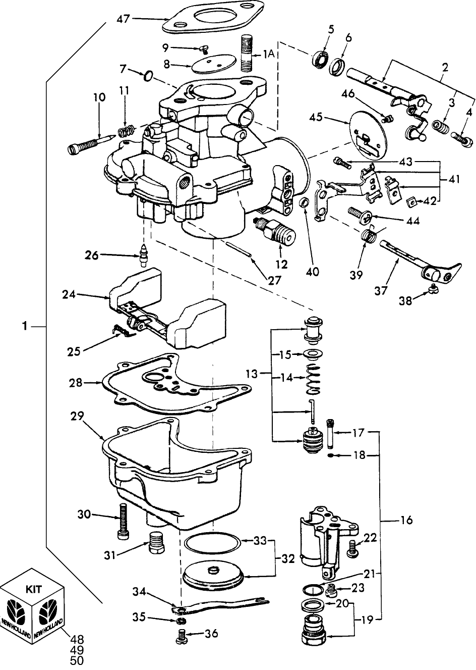

Hey Soundguy,That's an excellent job you've done there!
Maybe you could help me with my 2600 gasser,with a Holley carb.I'm looking for and exploded view of the carb.I installed a rebuild kit and it runs better than before but, I think the float spring is on backwards.
Do you know of any good resources on the web?
   / 99% finished on the 3000
#29
The cnh website has exploded diagrams of just about every part or assembly from all ford/fordsons from 39+
here's the parts list.. took me 2 seconds to find it and the pic...:
2600 3 CYL AG TRACTO / 09G01 CARBURETOR ASSEMBLY, HOLLEY
   / 99% finished on the 3000 #30
Soundguy,that's exactly what I needed!
My tractor only has 865 hrs. and has been barn kept most of it's life.
The only issue I have now is that it slightly smokes (black) at idle.
Maybe it's running a little rich?
Thanks for the great help.

black smoke is usually rich... those holley carbs can be cantankerous.. usually they get replaced with a 300$ zenith and then you get to work with your tractor.. not on it.
