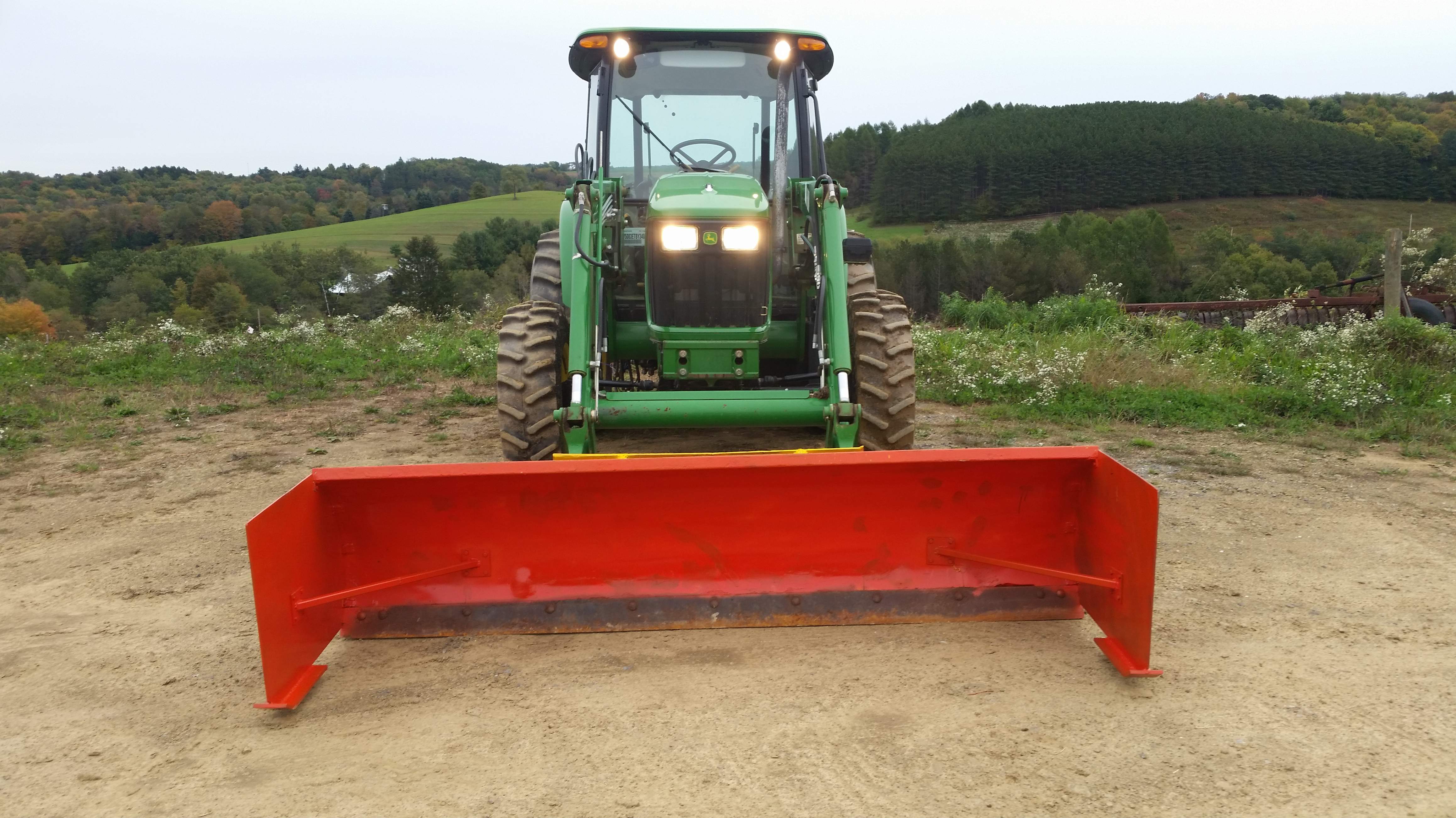

20151002_155513.jpg Well here it is. I'm not a painter for the record! The color was just what i had in excess in the garage rattle cans. The bits of black is the rust converter showing through. It actually looks kind of small on the tractor compared to the commercial pushers that I have seen. It will be at least another month or possibly two before we get enough snow to try it out on. Looking back at the moment I think the only additional thing I would change besides the size would potentially be figuring out how to make it float in a couple different directions. I was mainly worried about the durability and keeping the box as close to the front axle as possible as that was one of the things I hated about the power angle plow set up.

I have a long driveway with a very large parking area around 200x250 so it should be a good test. I actually think I could push a bigger box with my machine but without trying it out I'm not to sure yet. Since I have a nice bank that drops off the sidesof the lot and a 13 foot high reach I don't think running out of room to put snow will ever be a concern. A blower big enough to make worth while would likely be cost prohibitive and significantly slower than the pusher at this point.
