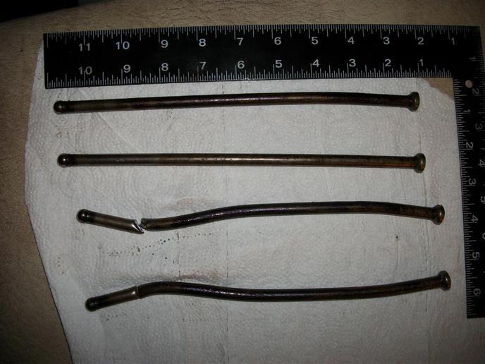

a54127.jpga54391.jpgI drove a 4 cyl ford 4000 off a trailer from a show, parked it in the barn, went to use it again, clink clink, clink, clink, clink, clink room,roomroom. that's right.. those were all pushrods bending from stuck valves!
I parked my 850 after unloading some hay, parked it by the barn to air a front tire. started it later.. clink! pop,pop,pop, chug running on 3 cyls. again. another stuck valve, and pushrod.
so yeah. stuck valves DO just happen... btdt, got the greasy rags!
My pushrods were bent soo bad I had to cut them with bolt cutters to get them out of the head and block. .. luckilly valves survived.
N is a hair different with that flatty vs an OHV engine.. but N valves surely can stick. btdt too.

Not trying to stifle your opinion. I just had issue with the 'it is not compression' statement.
It surely COULD be compression.. untill it is EASILLY crossed of the list with a thumb / palm check on carb mouth / plug holes.
A fuel stoppage test can ALSO be easilly checked spritzing fuel into the carb.. starter fluid.. etc.
you need spark, fuel, air, compression, and correct timing.
PS. driving 10-100-1000 foot and shutting down has -0- bearing on whether a valve can hang.
the op needs to reverify spark, verify compression, check fuel introduction.. if still nada.. check timing... I'd suspect timing last, AFTER valves in most cases.. yet again.. it IS possible. weve all seen advance mechanisms sieze and take flight. :)
