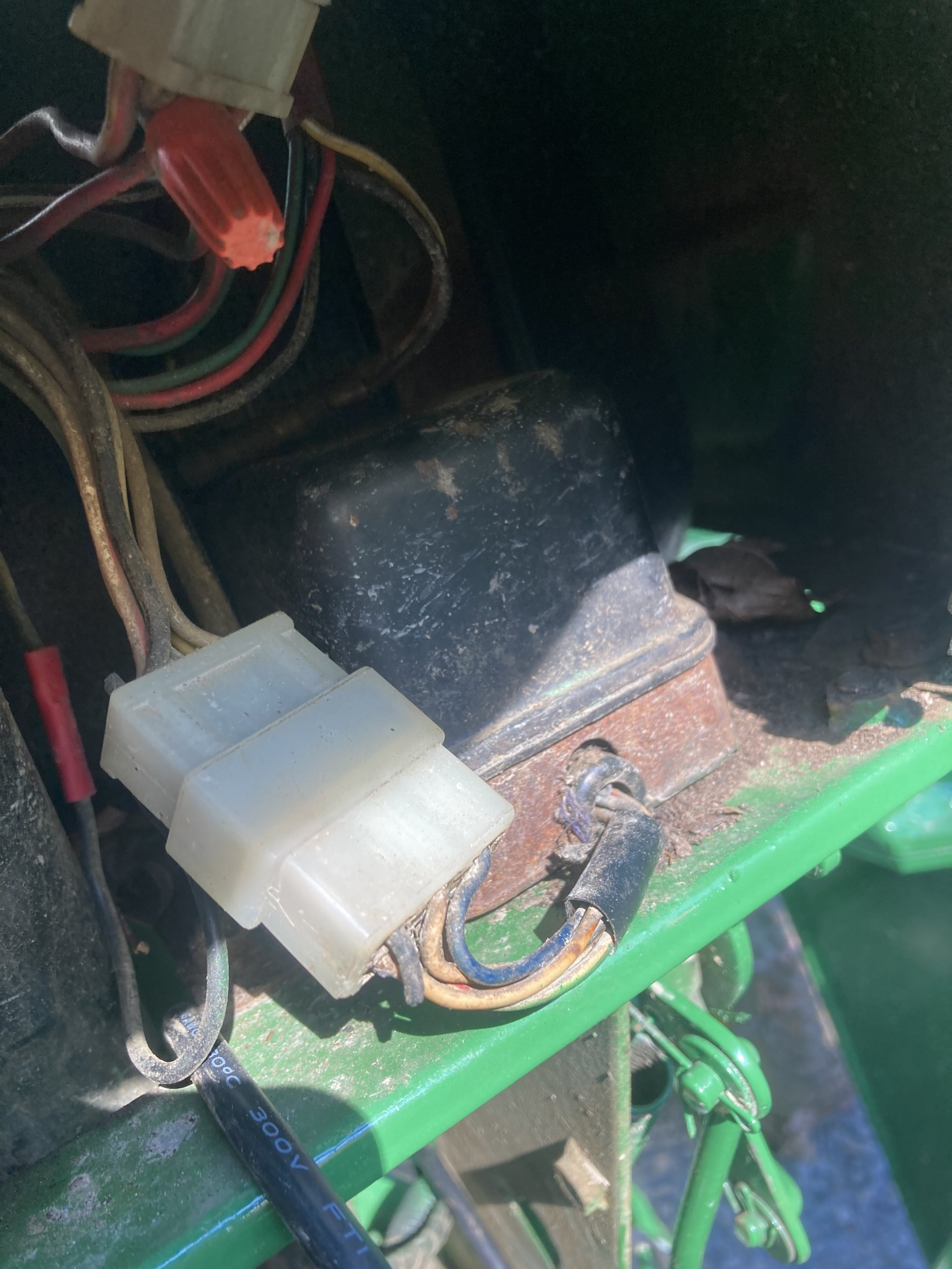

   / 87 JD 950 not charging
Is this the guy I’m looking for? Defiantly appears to be the older style
   / 87 JD 950 not charging #8
WOW, that indeed is the older style ! Prone to all kinds of troubles.
#9
For anyone that finds this useful, the voltage regulator was the problem. I check my voltage i was at 12.45 and swapped it, fired back up and checked it… 14.12
