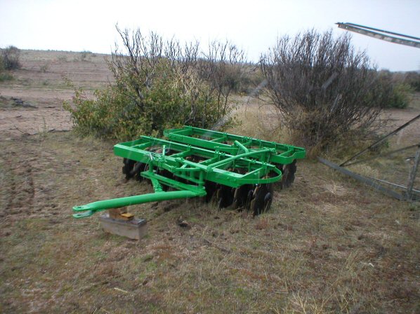

When you guys say how wide the disk is that you want to pull or are pulling, what type of disk, what size of blades, how heavy all make a HUGE difference.
Here's an 8' Kello-Bilt unit that none of Mahindras tractors will pull. Except with the wheels down maybe. :rolleyes:

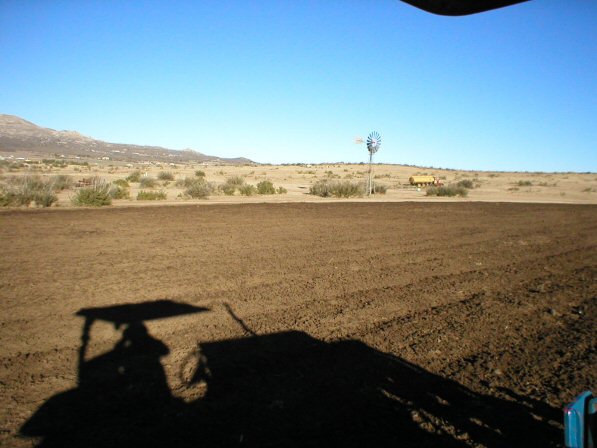

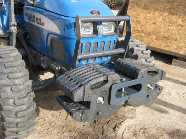

I have a 7520, about 600 hours on it, no tranny problems, no problems at all really. Ballasted to a bit more that 10,000lbs without the loader and on rolling terrain my old 8' Kelfer offset disk is all it wants. This is a disk with 22" blades and weighs about 2600lbs-2800lbs. I would forget about a 10' disk if it were me. But then when I disk, I am usually 8-9" in the ground. ;)
