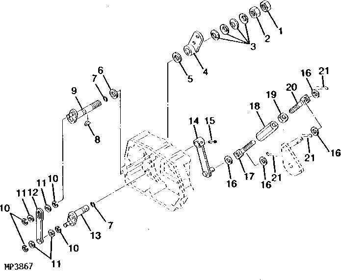

I had a tree get jammed in my lift control and broke the plastic quadrant and bent the lever. I repaired the quadrant with epoxy and straightened the lever. Now when I try to position the lift arms midway the lever returns to the low position. The quadrant slot has a recessed section at the rear which would seem to be there for locking it in full up position but it always stayed right where I set it before this happened.
Any ideas?

Is it possible you just need to tighten the friction pad/washers ? (if indeed there is such an adjustment on the 855).
/ 855 Lift Control? #5
You probably need to tighten nuts( 2 & 1) to put more pressure on cupped washers(part key 3)
I will give that a try. Can't find any mention of this in the service manual so I guess I'm overlooking it.
/ 855 Lift Control?
That seemed to take care of it. I think the friction of the handle rubbing on the plastic guide was holding it before. I straightened and bent that to get some of it but this friction washer adjustment makes that unnecessary.
