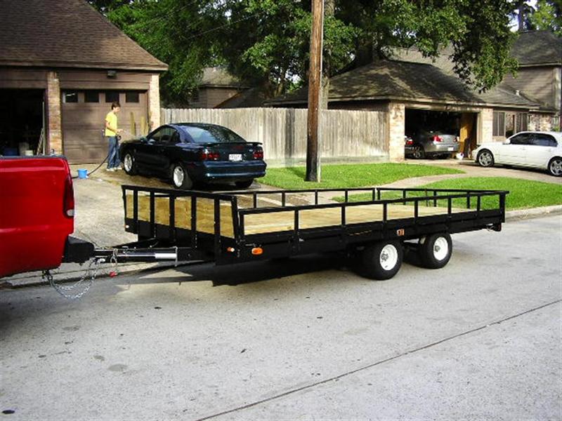

I think the regulations regarding homemade trailers vary from state to state. To get it registered some states only require that you have a notarized affidavit stating who the trailer was made by, and that it is free from all encumbrances, and that all the materials used to construct it are paid for. Other states require that in addition to that an inspection be performed by the DMV who will assign a VIN to it.
When I built my twin axle(3500#) trailer I had some expierence with tagging a homemade trailer. The lowest class is the trailer is 500# and the load is not more than 1000#, total 1500#. I tagged 3 that I made like this. Just walk up and get the tags. With this trailer it was a little more confusing, as I read it I would have to get it inspected and stuff if I recall. But when I got down to the tax office to get more info, the young lady said twin axles can be under 1500# in weight and a total weight not to exceed 4000# (if I recall). This was perfect for me, 1500# trailer, 2500# tractor with a mower and I was good. I think my tires are only rated for 4500#. Of course the truck takes some of this weight to. I just got the renewal and I think it was $55 for the year.
