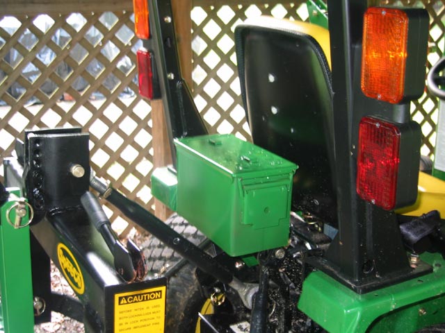

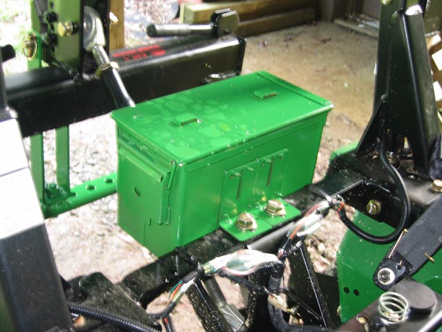

/ 790--Tool Box #5
A picture of how it is mounted to the ROPS.
I sprayed the inside with paintable rubberized undercoating.
