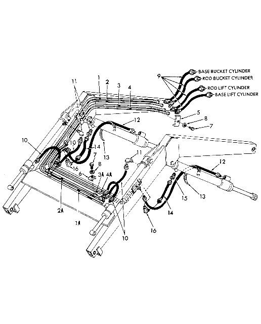

Hey all,
I had to take the lever attachment off of my loader to fix it. After I realized I did not make a diagram of the hose connection. Can someone help me out by providing me a schematics for the loader hoses, the order on to the lever attachment?
Thank you very much
/ 771 loader on ford 1900 #2
Tractorgirl, I may have an owners manual for the 771, but it is fairly simple to determine.
1. Move the loader lever forward and backward while watching which spool moves, upper or lower. If if is the upper spool, then the upper fittings are for lift/lower and the lower fittings are for the bucket dump/fill. If it is opposite, then follow according to findings.
2. Follow the lines from the lift cylinders back to valve hookup. Once you have found that pair, plug them into the upper port fittings and the other pair into the lower set.
3. Start the tractor and activate each circuit. If the lift or bucket is opposite of what it should be, lower the loader, shutoff the tractor and cycle the loader valve in all directions to relieve pressure. Reverse the pair of hoses for the circuit that is not correct.
You can't harm anything by crossing any of the hoses, but if you follow the procedure outlined, you lessen the chance.
Good luck.
If the illustration shows up, as it would not load, it helps illustrate the hose positions.

I have reattached the hoses but the bucket only raises up to the headlights and will not tilt. I checked the fluid level and its fine.
EDIT******
I did have two hoses backward, fixed them and it works perfectly now! Thank you
