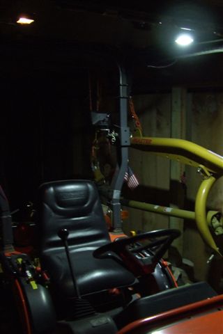

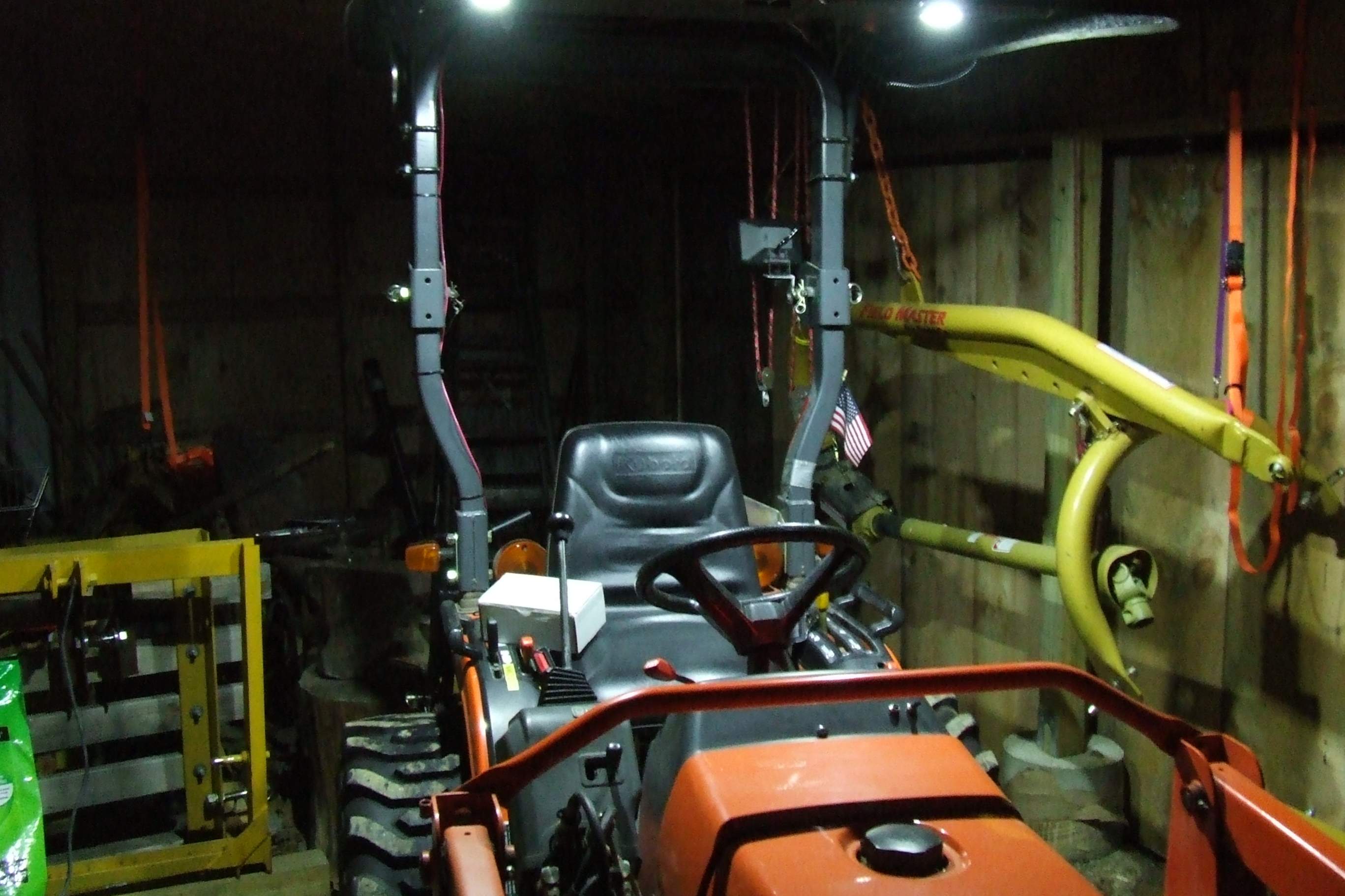

After spending way too much time thinking about it, I started on some new lights for my 7610. I plow most of my snow at night after work and get tired of not being able to see around the tractor or over the loader.
The first setup was to add some "cab" lights to my canopy. I picked up a couple of Wal Mart cheapies, but they weren't too bright. After visiting one of the sponsors from TBN, I ordered a 1 1/2" x 1 1/2" 9 hi intensity LED array. They're supposed to be all light and low heat. I tried one out, and the next two pictures show one light changed over and the second with two lights switched to LEDs. I didn't use a flash for any of the shots. It worked so well that I bought more LED bulbs for other uses.

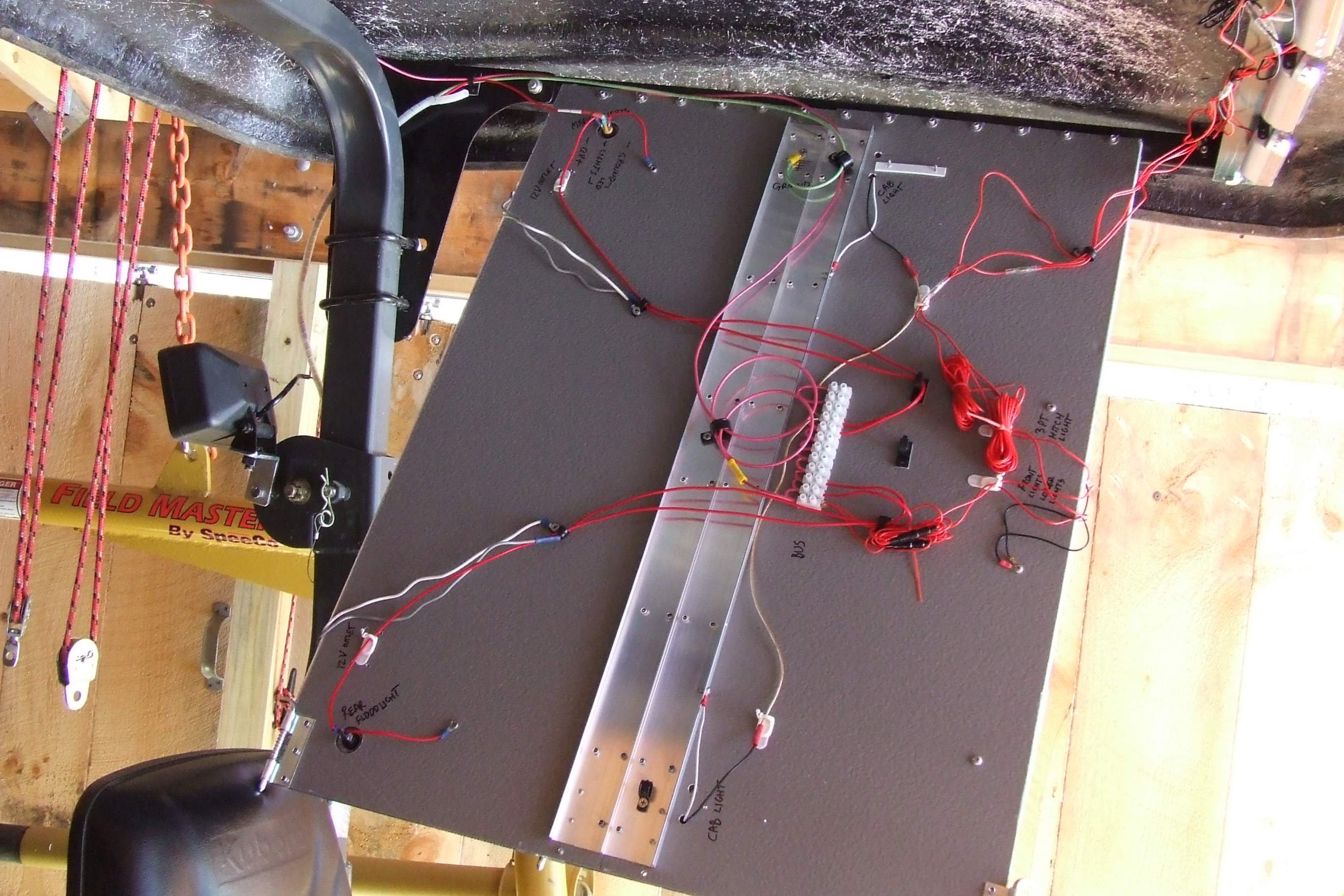

More photos coming Rusty. It was a whole overhead panel install. I wanted to keep the switches out of the rain.
/ 7610 lighting refit

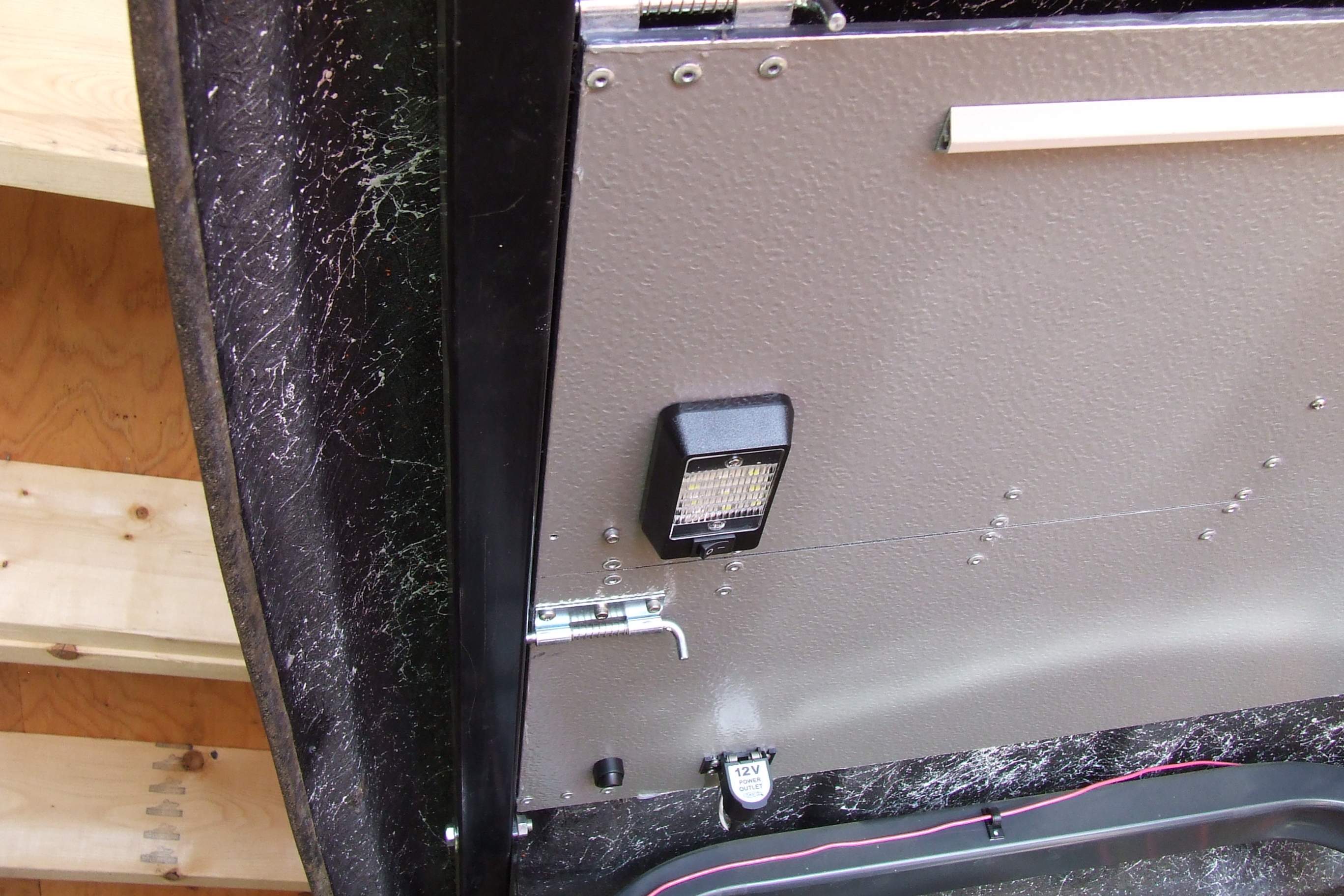

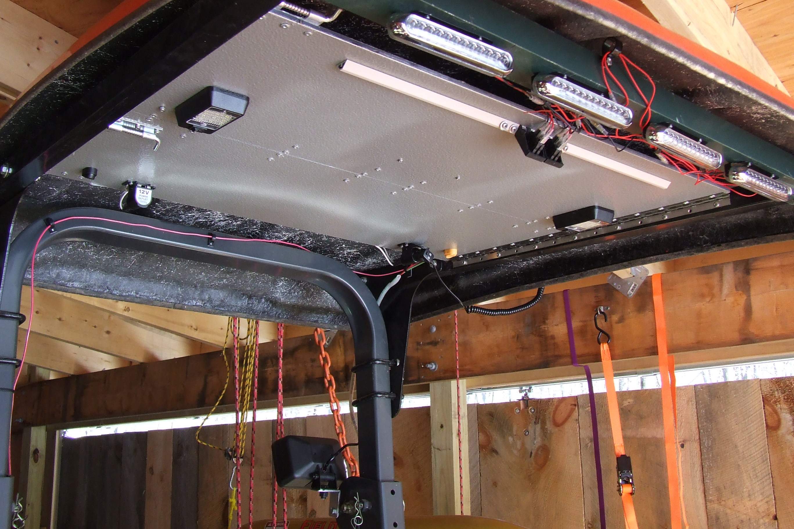

Here's the pictures of the headliner.
It attaches to the sun shade frame by stainless piano hinge on one side, and slide pins on the other side. I hinged it so I could work on wiring from the ground and made it easy to add more stuff when needed. The buss in the middle is a power tap so adding switches or sraight taps is easy. The whole thing is powered from the keyswitched pigtail on the back of the tractor.
The headliner is made from double skinned aluminum panel with a corregated plastic inner layer. It's easy to ground and keep continuity for electrical connections. The LED rows in front give me close foreground light and bucket light that doesn't get shaded by the loader. Cab lights give me tons of light to either side of the tractor, and the switches in back run the rear worklight (also LED) and some LED clearance lights I'll add to the sides of the sun shade. The 12V receptacles let me plug in extra accesories like my amber LED beacon which is mounted on the top of the canopy by magnets. It comes off before I go banging around in the woods.
All the LEDs put together draw way less than the 55 watt bulb in the rear worklight which was also changed to a 9 Hi intensity LED bulb. Last but not least are the headlight bulbs changing to LEDs too. I didn't want to buy another alternator for the tractor so this was the next best thing.

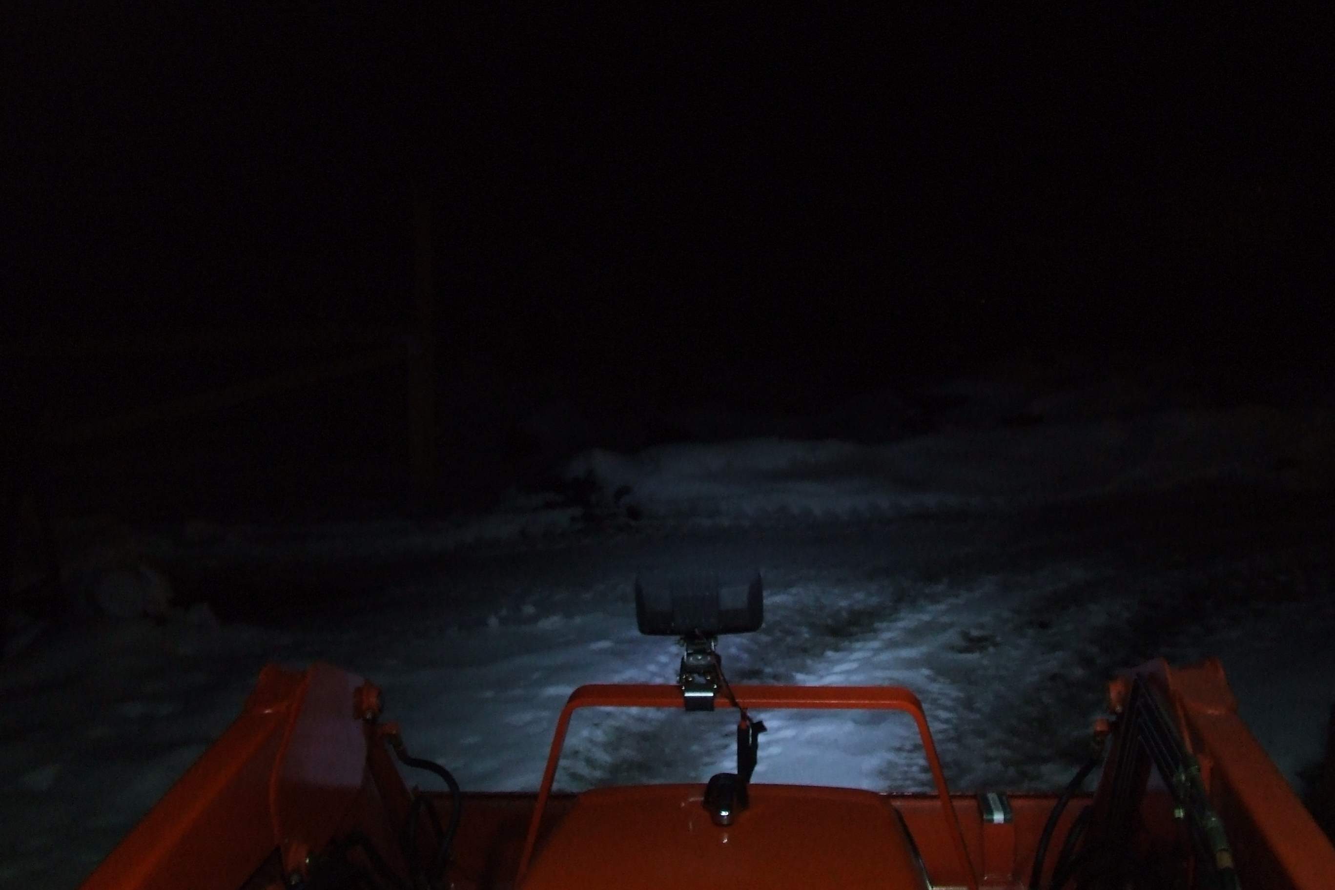

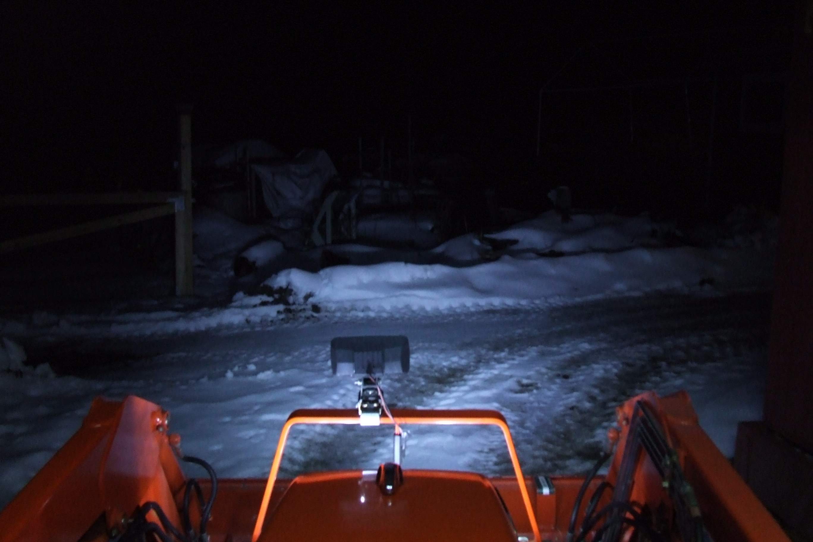

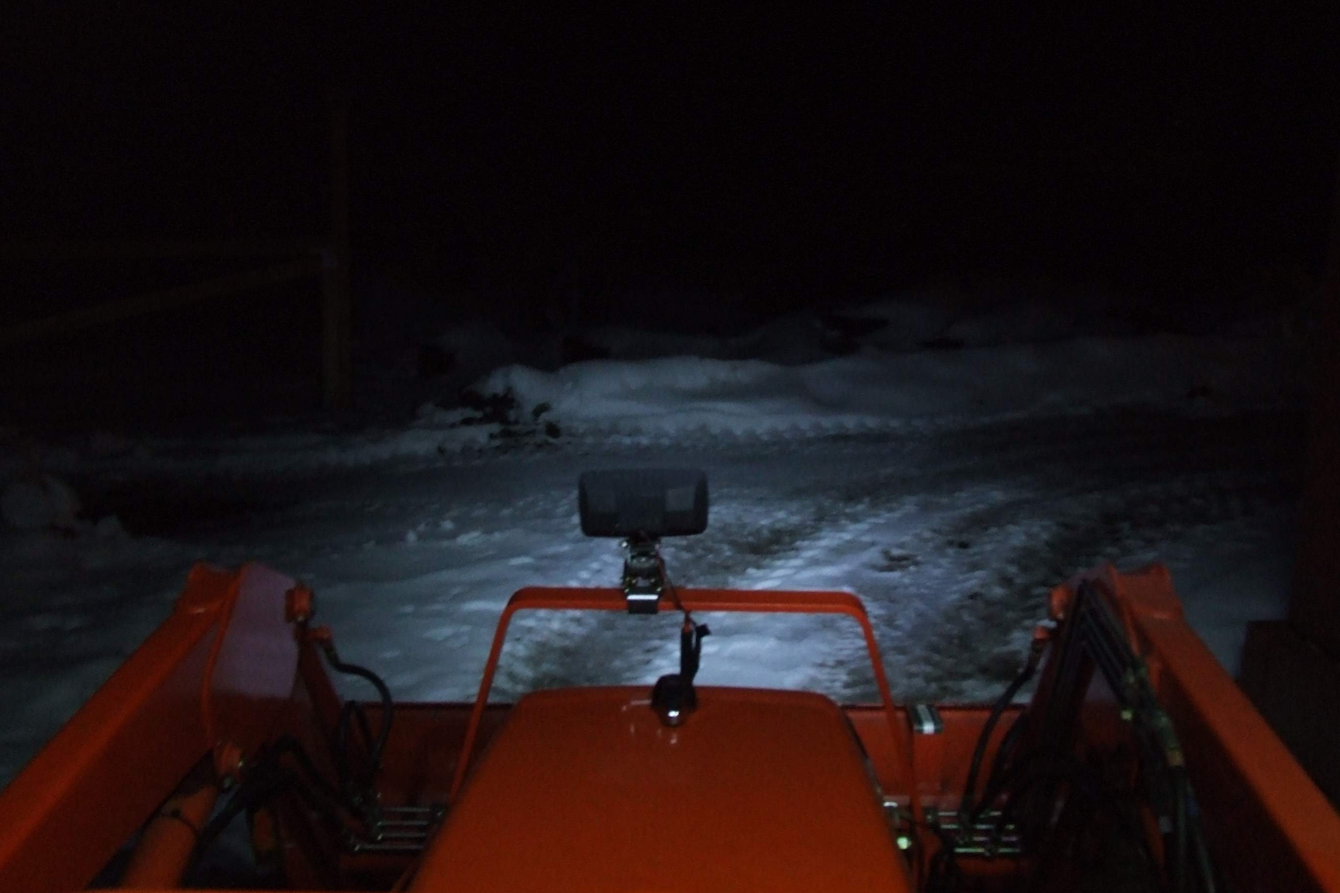

OK Rusty, here's a few shots from the operators seat. I'll get some with the bucket up in a few positions next.
That lamp in the middle was on the tractor when I got it. It lasted 2 weeks before the switch died. It gets in the way of removing the FEL too.
In the mean time, if you ever want to sell that tractor Matt, you gotta let me know. It would be worth it to truck it all the way to Massachusetts! The mods are just amazing. 4 Shorts, thanks for visiting and checking things out.

Here's some pictures with the loader in different positions and a from-the-front shot. Sorry for the blurry stuff. There's no flash on these shots so you get the best representation of the lights.
As you can see, the loader area fills in nicely even if you've got the headlights covered. If you're working up high with the loader, like dumping into your pickup truck, you can see the loader clearly without a lot of glare. Since the loader lights are under the edge of the canopy, they don't get affected by rain or snow.
