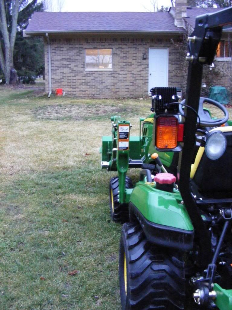

To say LEDs don't use much wattage is not exactly correct... Watts is more of a matter of output. LEDs do, however draw very few Amps (current). These LEDs draw 4 amps each, and in a 12 volt system, using the equation Watt = Amps x Volts, the output is around 48 watts output per lighthead.
Wattage and amperage are directly related if voltage stays the same. These are input values not output. Light output is measure in lumens and you get many more lumens per watt with LEDs than an incandescent. Great for us who have tractors with small alternators.
Nice lights. I would knock them off in the woods and would have them better protected for what they cost.
