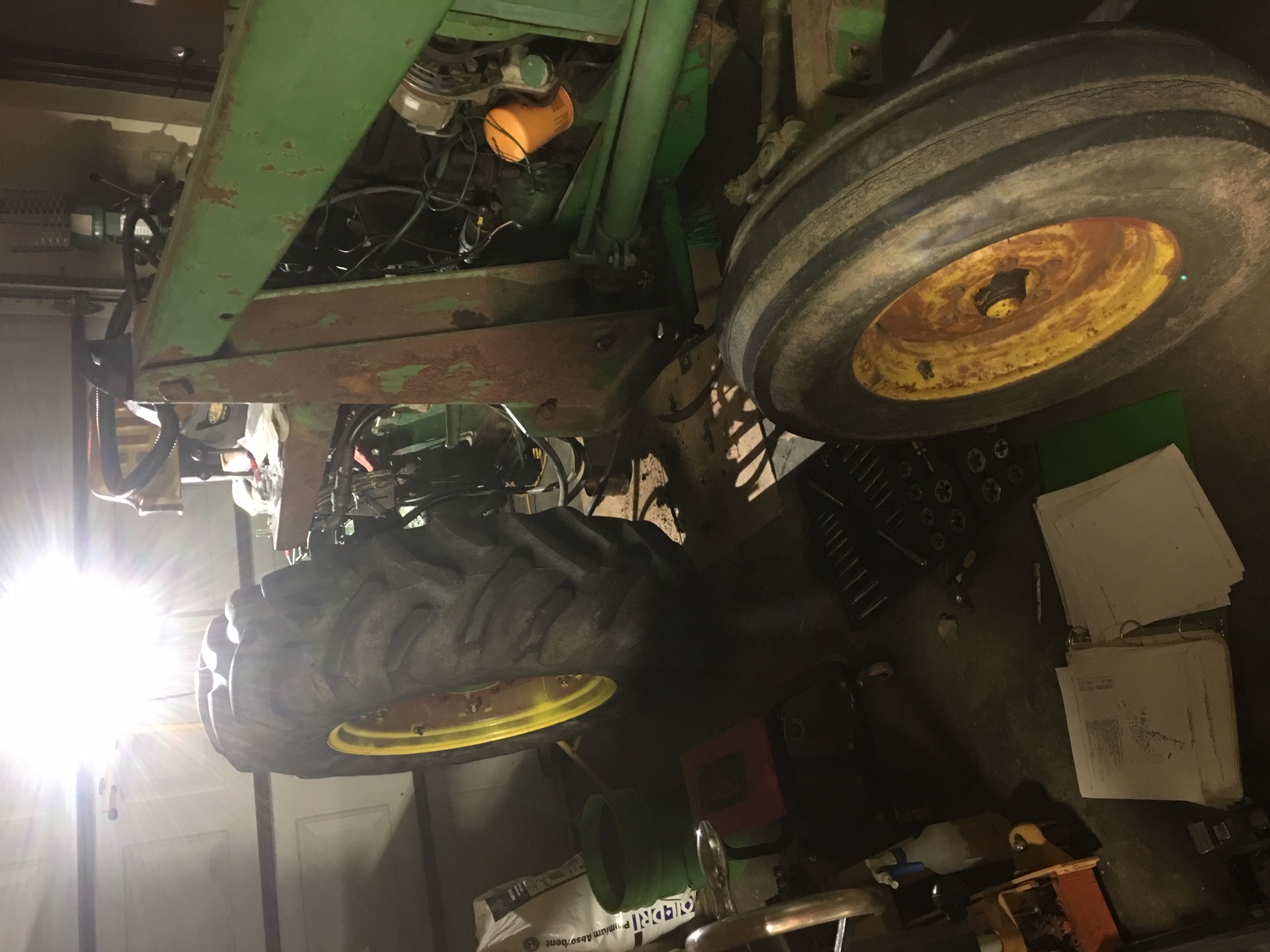

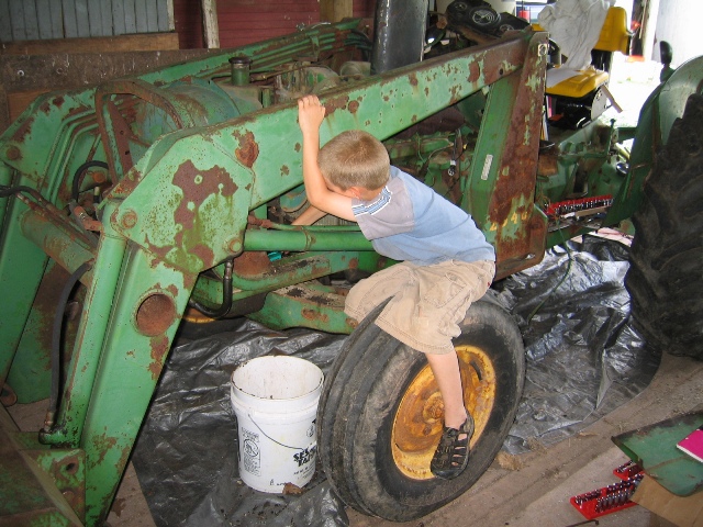

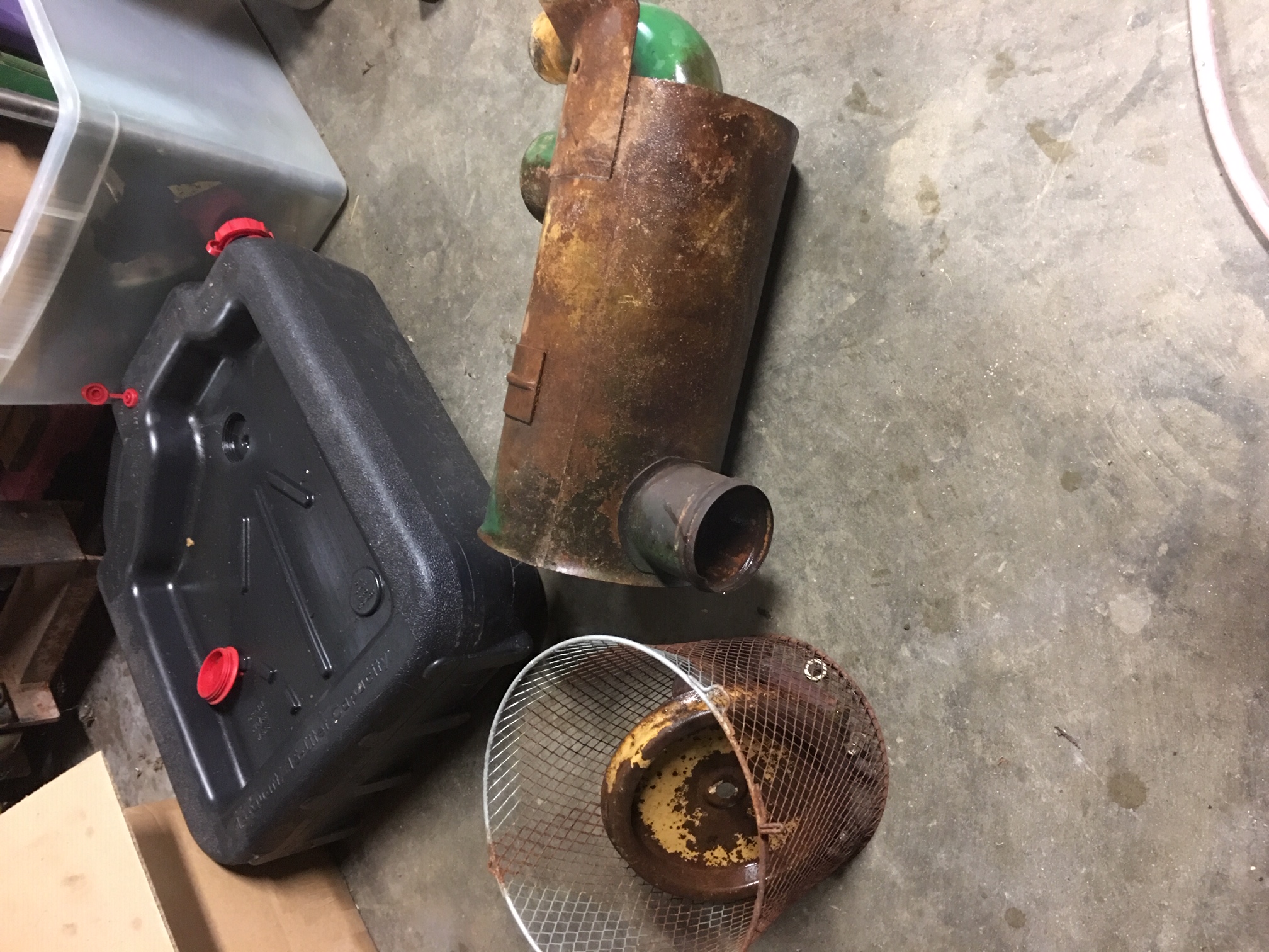

Hi everyone, I have picked up on the 2040 project as more of a restoration now (which was always part of the plan, just delayed longer). It's a project to learn skills on for my children and myself included. The goal is to have it fixed up and looking nice for next year's Holiday parade in town. The kids are excited for this and it has helped to draw them in more spending quality time together on the project.
I've been posting a few specific questions here and there and am beginning to believe its better to just have one thread dedicated to the entire restoration instead of numerous threads. I also see one thread as a way to record the project with the kids more like a journal.
So come watch a guy that has a lot to learn or feel free to join in with some advice. As always, thanks for the help and encouragement, it truly is appreciated!

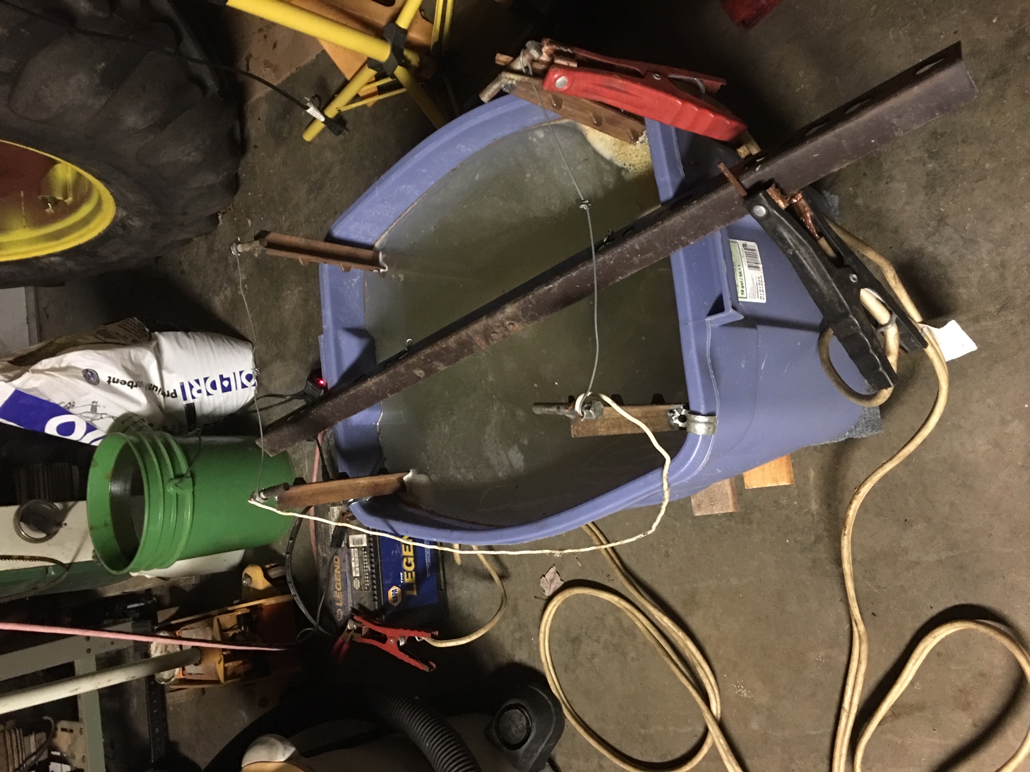

252572_10150620559705058_5119317_n.jpg1233257_10153233594845058_489140351_o.jpg59664494080__1DEBB2DE-E383-4138-85B6-527CC1A08D1F.JPGIMG_4603.jpg
Currently we've been experimenting with electrolysis for removing*rust. Cool stuff!
