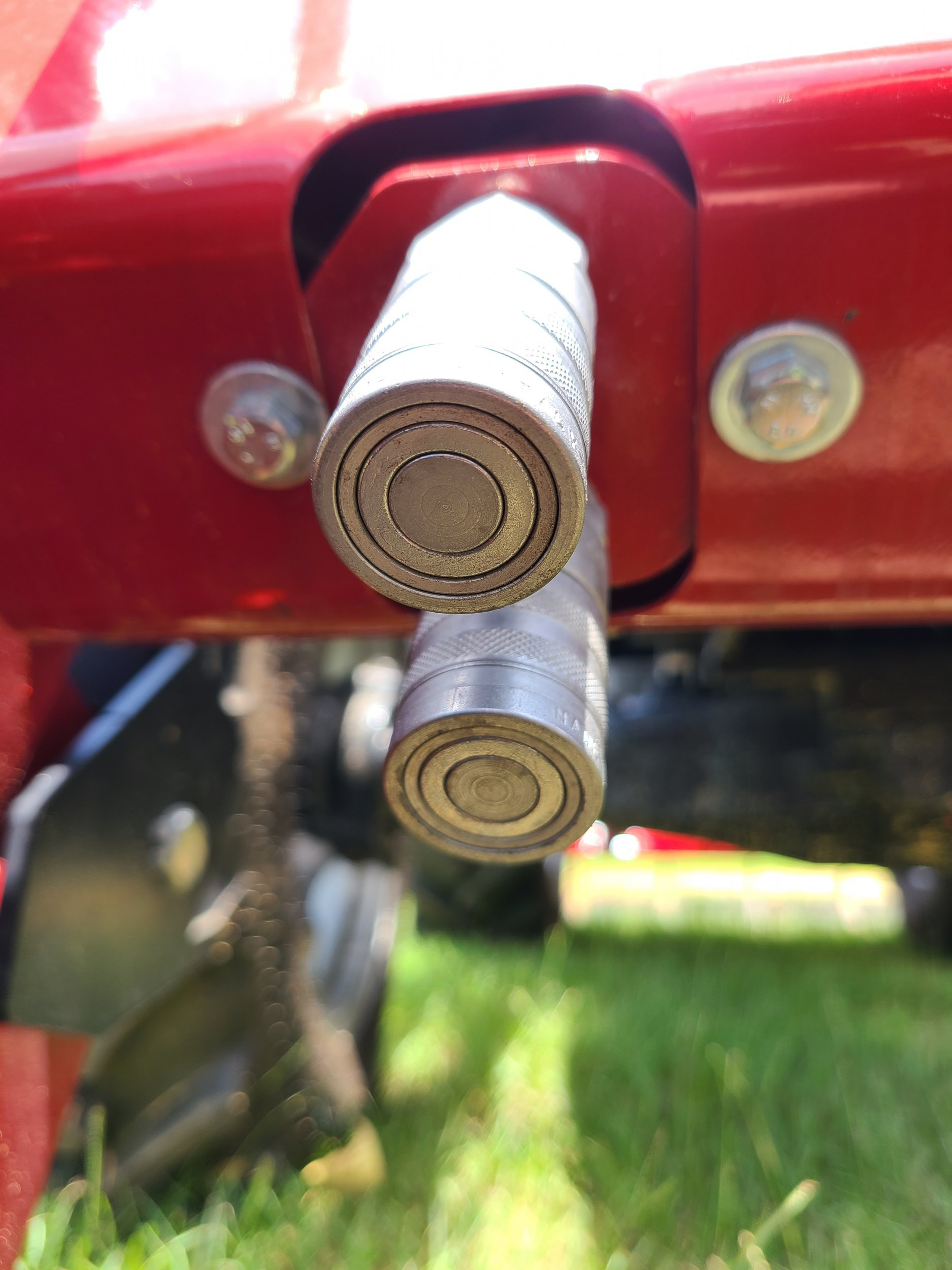

Hey all, first post here; first time I've ever been completely perplexed. Bought a new Case Farmall 75C a few weeks ago.

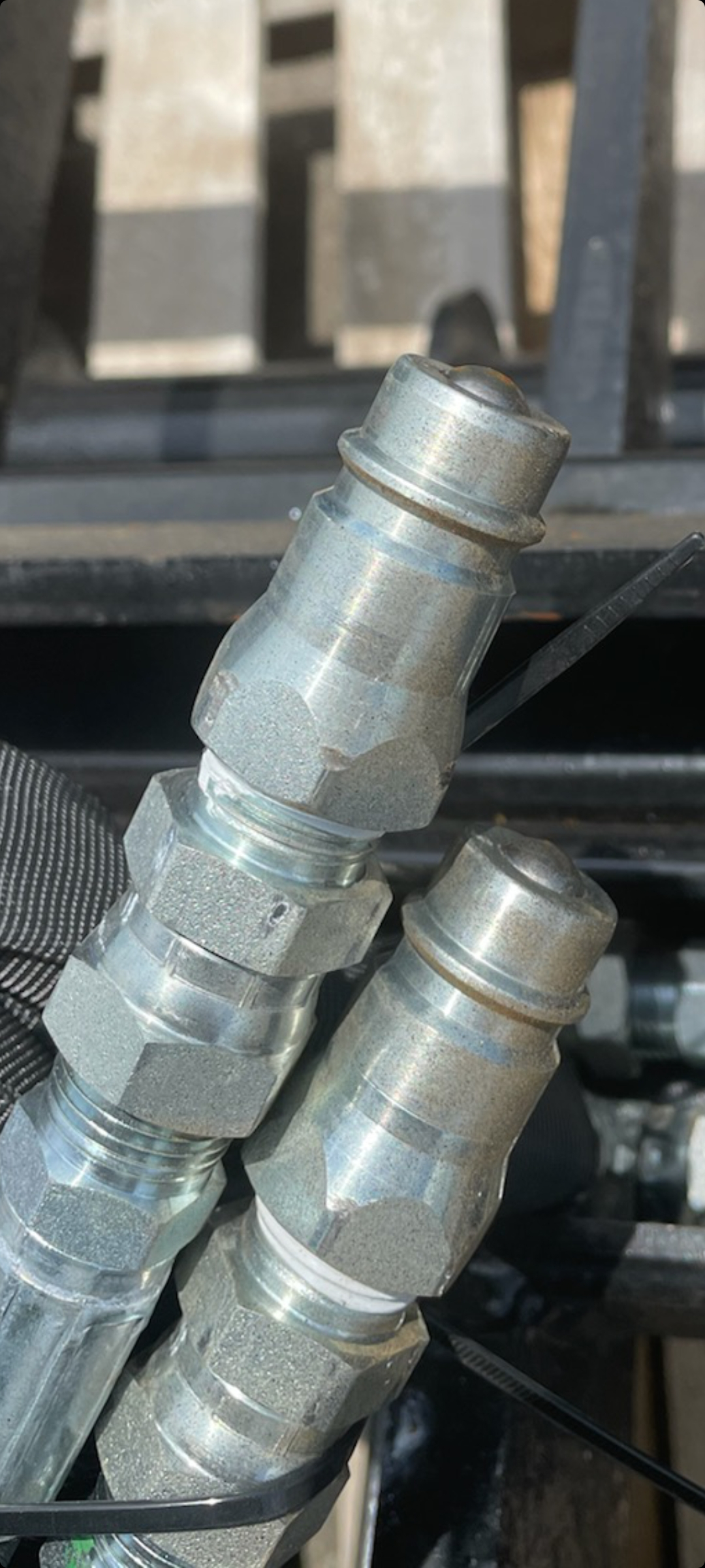

I picked up a grapple this weekend with standard 1/2" male AG poppet ends at the hose. They aren't even close to compatible. I went through $200 of couplers and adaptors this weekend and no luck.
Does anyone know what coupling goes on the end of a hose to fit these damn flat faced OEM 3rd function couplers?
I went to a case dealership by my place and they sent me home with a standard pioneer coupling; nothing about it fits, the threads, the size, etc..
How on earth does a guy find out what plugs into these OEM third function flat faced things?
Attached a picture for reference of the flat faced OEM couplers on the tractor and another of the standard ag connectors on the end of the house that are not compatible..
Any insight? Thanks y'all!

ISO 16028 (skid steer) ?
I believe there are 6 different body sizes: 1/4" up to 1" (nominal). Also each body size is available in several different thread sizes, so it's important to know the termination on the hose.

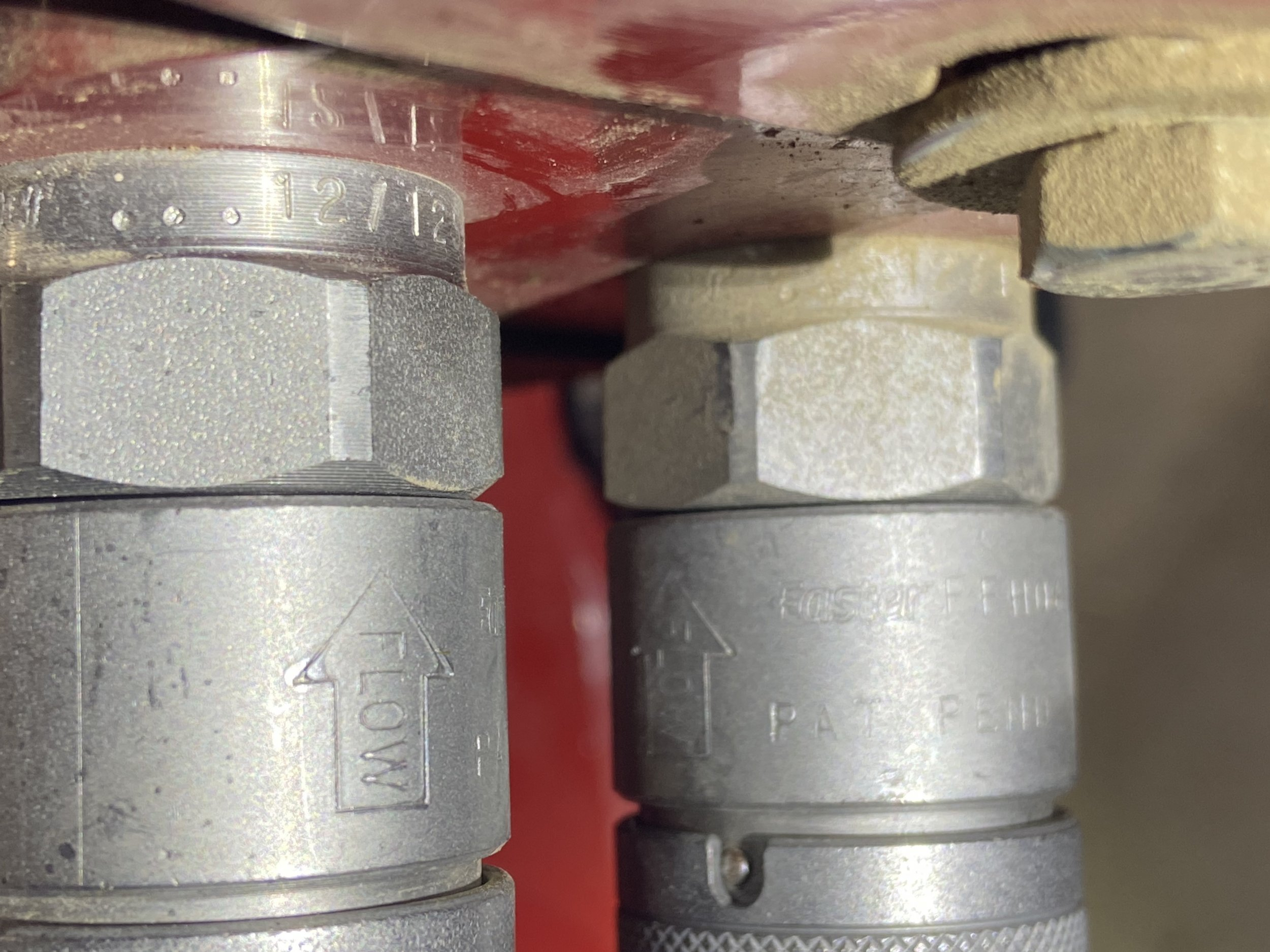

For anyone reading this thread to figure this out, a 75C comes with 3/8” body flat face iso 16028 connectors. 2 female connectors, not sure why especially when they show like in the attached pic. With Both flow arrows pointing the same way…. :(
