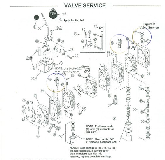

Now you got'em. Also, the 758C hoe has its own relief valve which is set at 2150 PSI. This does not affect the loader or other tractor functions
   / 758C backhoe ??????s
#12
Anyone have a pic of the relief valve???
   / 758C backhoe ??????s #13
Rick this just keeps getting better and better. I'm showing a total of 3 relief valves (circled) in my 757C control block breakdown.
With your position I'm sure you already knew that.
Relief #16 Work port. is set at 2500 PSI
Relief #17 Anti Cav. is set at 2000 PSI
Relief #18 Main is set at 2000 PSI

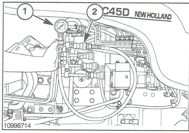

Your first post indicated that you have a 16LA loader. If I was going to make this test I would first start and operate the hydraulic system to warm the hydraulic fluid to normal operating temperature. I would then park and disconnect my loader to get it out of the way and make access to the loader quick connects easier to reach. I would then use the top high pressure hydraulic quick connect that normally connects your front end loader and connect to a 1-3000 PSI pressure gauge. I would then start the tractor and bring it up to 2600 RPM and move the control lever to the bucket raise position, the pressure indication on the gauge should show 2500 PSI for your TC-45D.
Watch that hose hooked to the pressure gauge because I'll bet its going to get stiff when the pressure hits it real quick. Or why not just have your dealer perform the tests for you and you won't be out the cost for the pressure gauge.

</font><font color="blue" class="small">( ( Rick this just keeps getting better and better. I'm showing a total of 3 relief valves (circled) in my 757C control block breakdown.
Relief #18 Main is set at 2000 PSI )</font>
Mike,
There may be even more than 3 relief valves.
Relief # 16-Quantity=2
Relief #17-Quantity=2
Relief #18-Quantity=1
   / 758C backhoe ??????s #18
Vince looking at the picture I do see two that I missed in the bottom of a couple of sections. Thats a slew of 5 relief valves on the backhoe itself.
