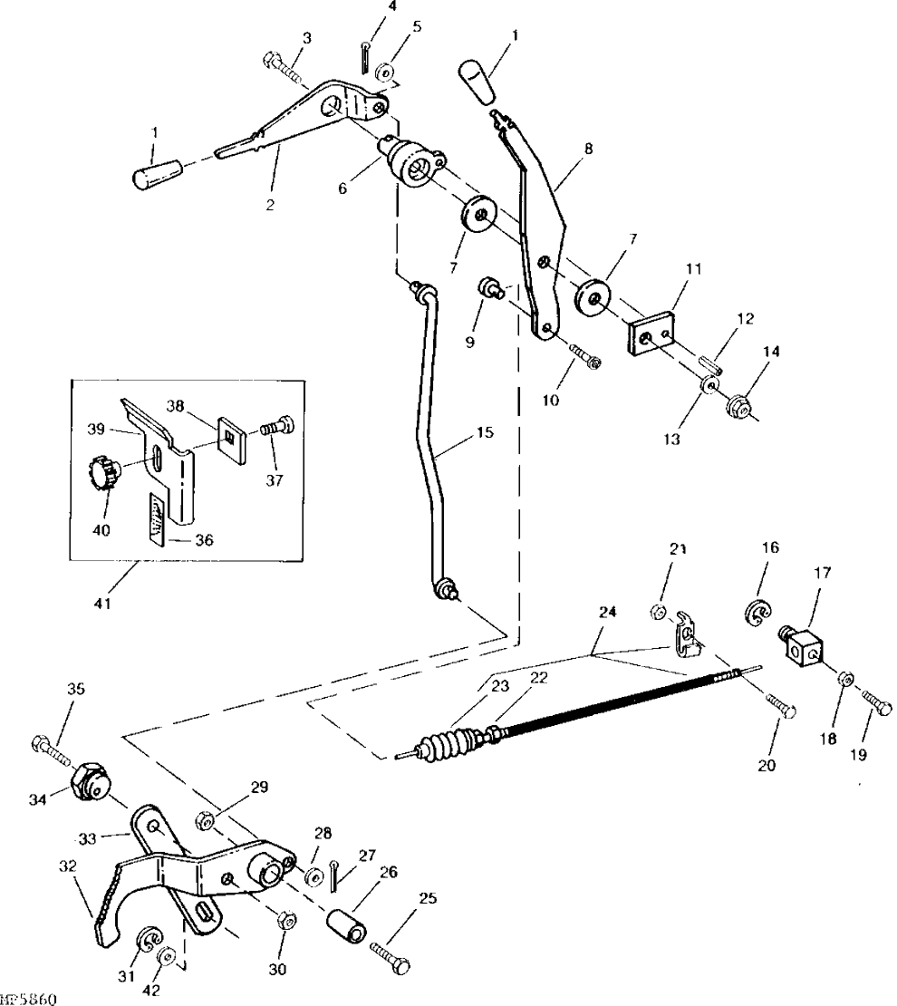

Hi folks, I am new to the forum. I have an 88 John Deere 755. It starts right up; idles fine but the engine seems to be vibrating a bit more than usual; but when I move the throttle lever there is absolutely no change in the engine speed?
Any thoughts or suggestions would be very much appreciated!

Welcome to TBN:)
Have you looked at the linkage to make sure it's still connected to the injection pump?

Thanks much for the prompt replies!
Rustyiron: I don't think there are many hours on the fuel filter but I guess it wouldn't hurt to change it.
kennyd: I checked and the throttle cable is connected properly and moves as it should.
jd110: everything seems to be in proper order regarding the hydraulics.
Some additional info:
I just talked to my 17 year old son; (he takes care of pretty much ALL of the cutting and trimming on our little 4 acres), he told me the 755 was running fine when he put it away and the next time he went to use it the problem showed up. He seems to feel that the throttle does not have as much resistance as it used to. I too think it feels a little too easy to move and doesn't seem to hold firm in position. Is it possible that that the problem is inside the governor housing?
