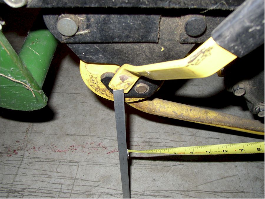

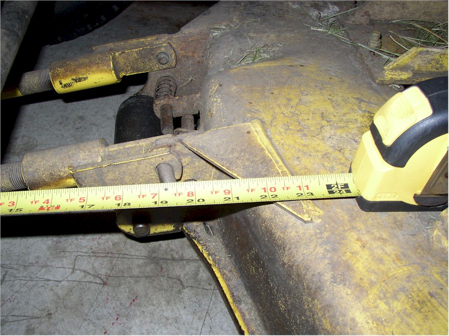

/ 755 Belly Mount Mower Mounting Problems #6
This is a pretty rough measurement, but if your draft arms are way too long as you say it may be helpful. The straight line horizontal distance from under the point where the arm attaches to the front bracket back to the attaching pin on the deck is a little over 19 inches plus or minus. Also make sure your rear draft arms are attached.
Definitely further forward where the draft arms mount, my bracket puts it directly under the rear pin! Thanks!!!!

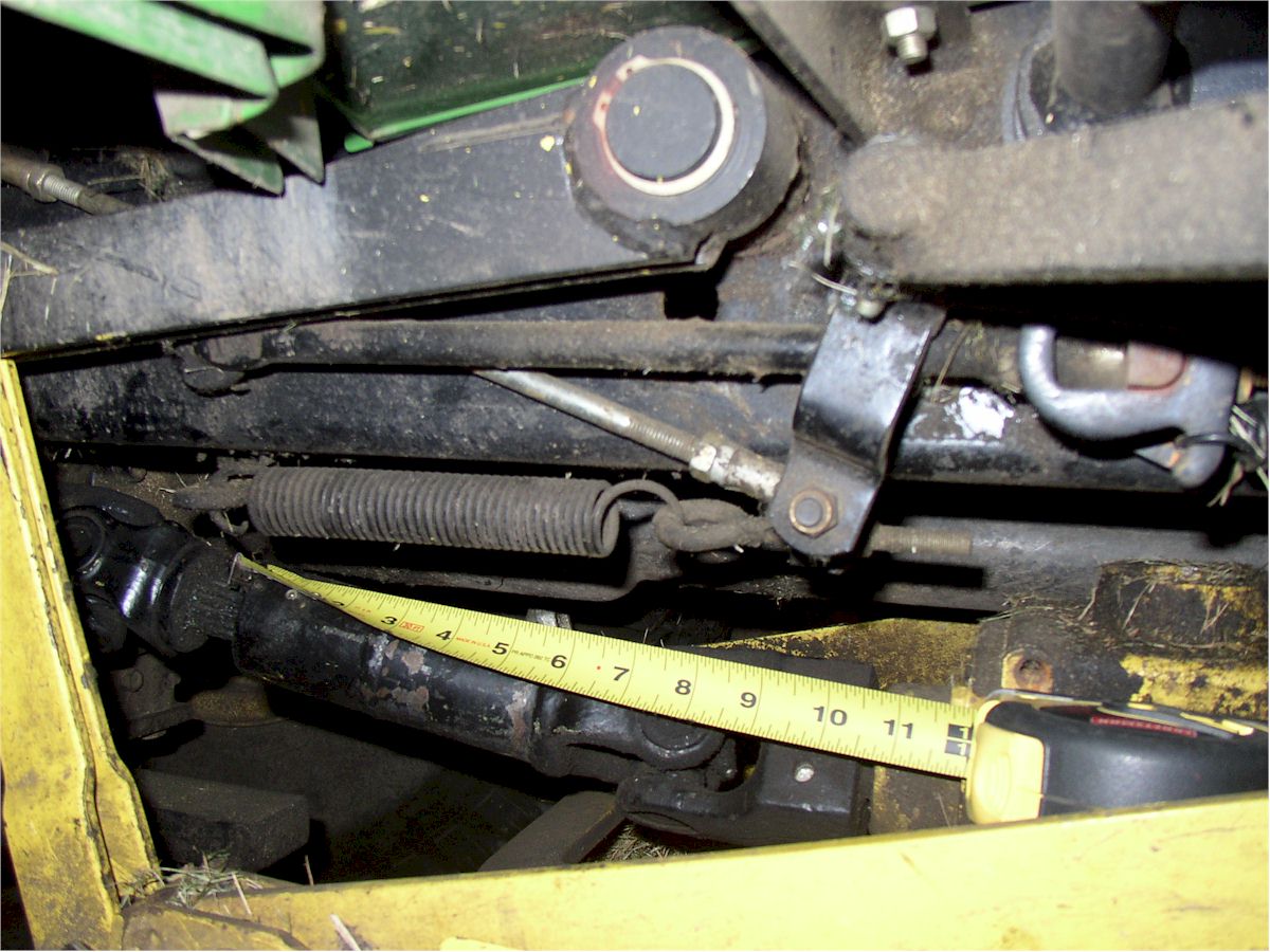

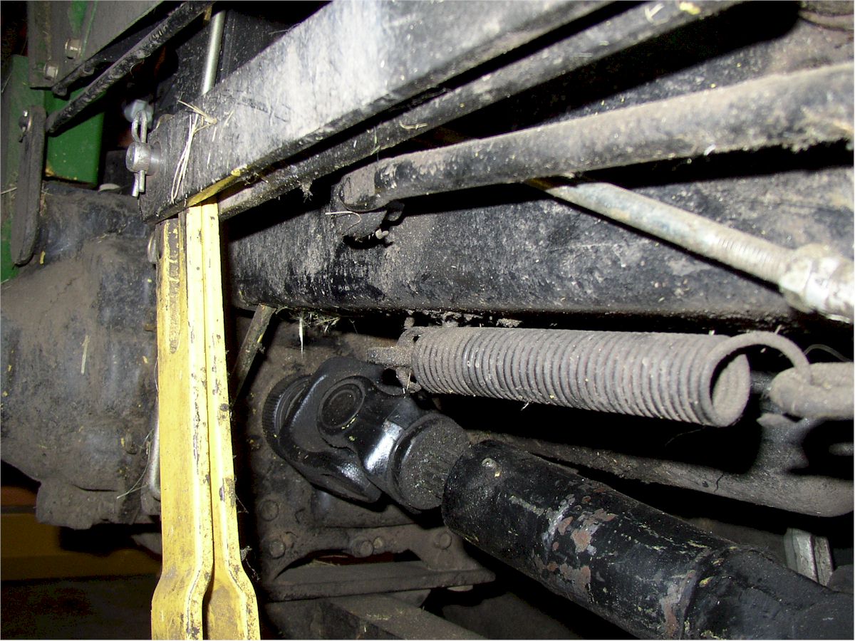

how long should the driveshaft be for the 60" mower on the model 755? I have the same problem and I can easily adjust the arm length but the driveshaft is another problem...
/ 755 Belly Mount Mower Mounting Problems #11
The front portion of the driveshaft including the u-joint is ten and one half inches.
/ 755 Belly Mount Mower Mounting Problems #12
Thanks for you previous response.
What is the length from end to end?
/ 755 Belly Mount Mower Mounting Problems #13
The overall length will vary of course since it is a slip connection. Later I could try to get farther under and measure the current as installed length.
BTW, welcome to TBN!
/ 755 Belly Mount Mower Mounting Problems #14
Hard to get a real accurate reading. The deck is raised because the loader is installed and it's pretty tight under there for both viewing and holding a tape measure. The rear section of the drive shaft is six inches including the coupling collar. There is one inch of spline shaft showing. So the current overall length as installed with deck raised is about 17 and one half inches.

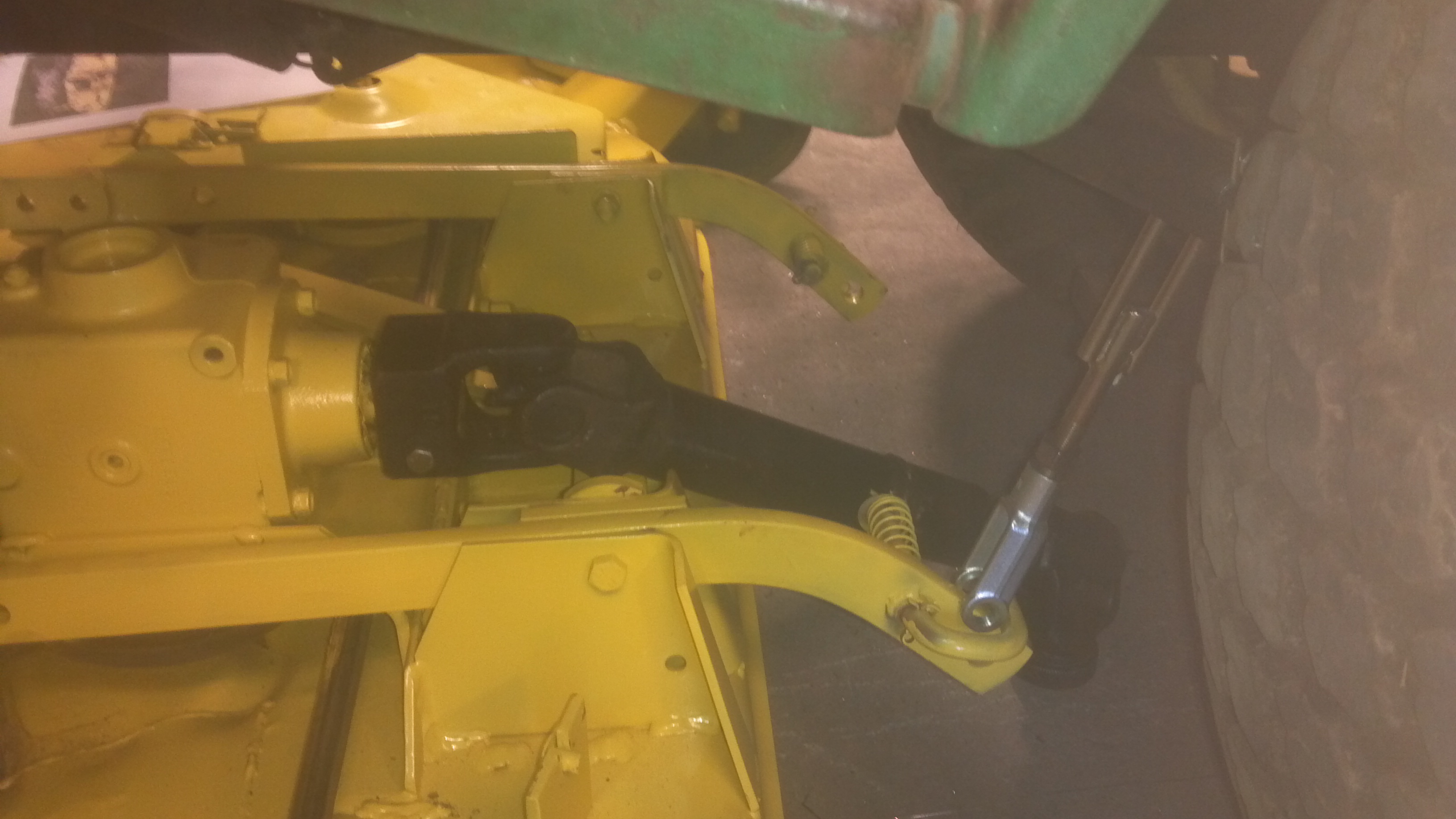

thanks for the information. That explains why I have had so much trouble with it. It appears from seeing pictures of a 755 mower deck, the gearbox is on the left side of the center blade pulley where as on mine it is on the right. I have cut the drive shaft down shorter and when I hooked it up it does turn the blades even though the drive shaft is offset quite a bit. The arms that connect to the bottom brackets under the tractor were very tight to connect. This is probably due to the arms not being correct either. They curve down at the rear of the deck as if they are actually for a 750 tractor (when looking at pictures on ebay). This I believe is a simple fix as I think all I need to do is lengthen the rear lift arms to connect to the lowered deck arms. I know I will have to modify the front draft arms as they appear too short (by 2 to 3"). That or I spent $80 to buy the draft arms off a 655 tractor for a 50" deck which is currently on sale on ebay.rear mower deck arms.jpg. I have enclosed a picture of what I have. Keep in mind that the rear of the arms will get lower as the front of the arms will be raised to connect to the tractor.
