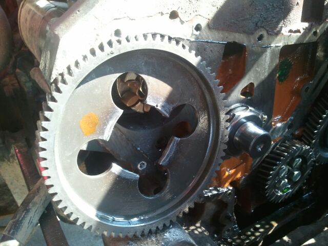

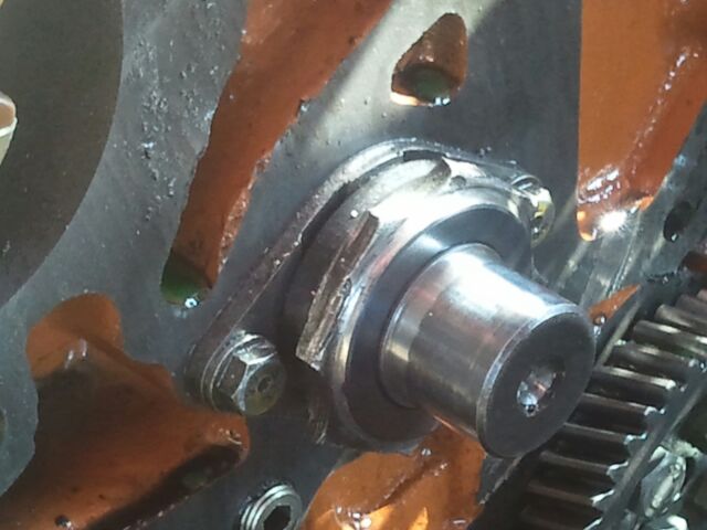

I have a 2007 7520 with 500 hours on it. The tractor recently died while driving it to my camp. The engine sounded like it had no compression. When we pulled the timing cover the camshaft gear had sheared off the camshaft. Has anyone had similar problems. This tractor only has 500 hours and has been operated by me 95% of the time. It has been worked but not abused. Of course it is out of warranty, but I noticed that Mahindra discontinued the two piece camshaft and replaced it with the one piece gear and shaft. I suspect they either realized the original was poor design or had problems with it. Pictures are attached, I think. It appears to me that a gear that would shear like that is either due to faulty materials or design. Any suggestions/ comments would be appreciated.

I would check to see if there is any end to end play in either your crank, cam, or any other gear that contacts the cam gear. Just a guess, but looks like the cam gear was being acted on by a side force that flexed/cracked it near the cam shaft over time. Also, this 'looks' like it could be called a one piece design... [ not an expert here, but had lots of years working on stuff ] Good luck, Jerry...
/ 7520 Broken cam gear #3
Back in 2006 or 2007 I think there was a failure like this reported on TBN. But I haven't seen one since. I think that fellow thought the cam gear was getting too much side load from the hydraulic pump...but I am stretching a poor memory. They have since updated the cam with a shrink fit cam gear instead of a bolt-on gear, which is of course stronger. It is only sold as a cam/gear assembly. The cam is also extended and is now supported additionally by the front cover. It is just a more robust design. Your dealer can pull up the service bulletin and let you know what you will need as far as parts to update to the new system. Keep in mind the manufacturers have a right to continually improve designs, and that does not mean that a failure out of warranty becomes covered.
If this is a defect, that is exactly what a warranty is for, defects in material or workmanship...but the kicker is that even if you can prove a defect and absolutely no neglect on your part, reimbursement is still limited to problems that manifest themselves in the time period (time or hours, limits on both). If you have a 2007, you had a three year warranty, so you are out by maybe 2 years. Just giving you a heads-up on how that normally works, so you do not think the fact that this has been upgraded is a smoking gun leading to coverage.
The good news is that the new design is super stout, and if you can do the repairs yourself it should not be all that expensive and you won't have to give that cam gear another thought.
Talk to your selling dealer and see how he can help. I just looked it up and the kit is part number 006004516F91 and is not as expensive as you might think since it looks like it comes with the cam/gear, cover, gaskets, bearings, compatble hydraulic pump gear, etc. Looks complete. We have sold quite a few 7520's and we have not seen one fail, so it isn't common. We have never installed the kit ourselves.
I hope this helps, and good luck getting this going. Sorry this has happened to you, but at least the fix is an improvement.

Your memory is good Dave. That was me with the early failure -- at around 200HRs. Dons failure looks just like mine and pics fit your description of the improved design I think. :eek: On my replacement the web portion of the gear was about 0.010" thicker and finished better in the holes where cracks would start due to the helical profile and the inherent continuous opposing thrust loads following the idler/cam gear as it rotates under load.
Those holes are needed to get to those bolts to remove and install the cam assembly and they are the demonstrated weak point. I use my loader a LOT and hit system relief pressure dozens of times per hour sometimes. The tractor now has 1100hrs and seeing this failure on Dons later model 7520 has me pretty worried.
...Dave, do you know if the design shown in Dons pics is representative of the final upgrade?

Looking at the gear design itself. the lightening/handling holes were too close to the hub and the web is too thin. Obvious flexing occured as other posters have pointed out.....what i see is a very repairable situation. if in the future the SHTF, i would not be afraid to weld it back together and use a reinforcing disc for the patch on it. Seeing the part is avaialble, i wouldnt do it now...just saying if the SHTF and you were on your own with it.

But how would you assemble it without the holes? A new design is needed. This one, at the 2007 snapshot, is showing to be a latent defect. There can be well over 30HP crossing that idler counting the 17GPM main pump, 5GPM steering pump, alternator, fan, and cam.

Not sure how the holes play into the assembly of the gear......never had one in front of me to really know.
Usually holes in the web of a gear or pulley are for a desired heat treat effect on the inner or outer parts of a gear, handling holes or racking holes for processing during manufacture, simply lightning holes or to save material in the blank casting process.
In this case, if the breaks of the webs could be aligned again, there could be a disc or a basic "patch" welded in so it could be used again.......this would only be attempted in a situation if no replacement could be found.
