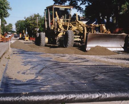

Have you explored one of the gravel-grid systems? I have 2 colleagues who have done it over old concrete pads (leaving the concrete in place)
This never crossed my mind....and honestly would be ideal if it works. Definitely worth looking into, thanks!

Lot's of great ideas....really has me thinking.
I've looked into mobile crushers, though maybe not quite enough.
Right now my top 3 choices seem to be
1) Geo grid on top of the concrete...no demo, no waste. Money saved could cover geo grid costs and would have a solid, weed free base. How easy is it to load gravel on top though?
2) Mobile Crusher/Reuse Concrete
3) Look into contractors needing concrete waste, may haul for free
The demo seems to be fairly straightforward an really doesn't seem to be a problem per-say. It's what to do with the waste.
   / 750' Concrete Driveway Demo/Refinish Help #46
Whatever that involves removing 340,000 lbs of anything strikes me as a job too big for a non-professional. The geo grid on top of concrete looks good. If you'd like the nicer look of asphalt -
Lay the above on the concrete and call in someone to lay asphalt over same. A word of caution on the asphalt. There are enough ways to cheat the consumer and provide an inferior job, it's worth hiring a consultant who, in addition to helping with the specs, is to be on site during the laying of the asphalt. Be sure the contract calls for a minimum thickness throughout - not just average thickness.
OR, just fill the cracks and voids with cement. Geo+base + paving =$$$$ and without a proper base will inevitably settle and crack. Just yesterday I was told this years average in our area is $3.00/sqft for asphalt.
