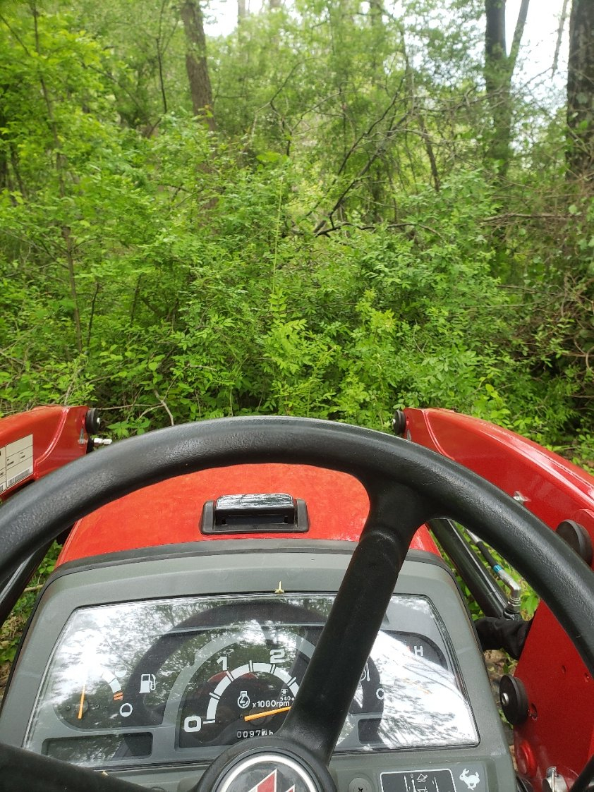

I work 80 acres of tree farm in Pacific County, Washington with slopes and wintertime mud. I use a 25 HP CUT (any brand will work). If you have winter mud like mine, consider R1 tires instead of the R4 tires CUTs usually come with. A little hill on an unpaved skid road will put you out of business in the winter with R4s.
That size of tractor will pull out any log you are likely to feel comfortable falling (unless you are a professional faller).

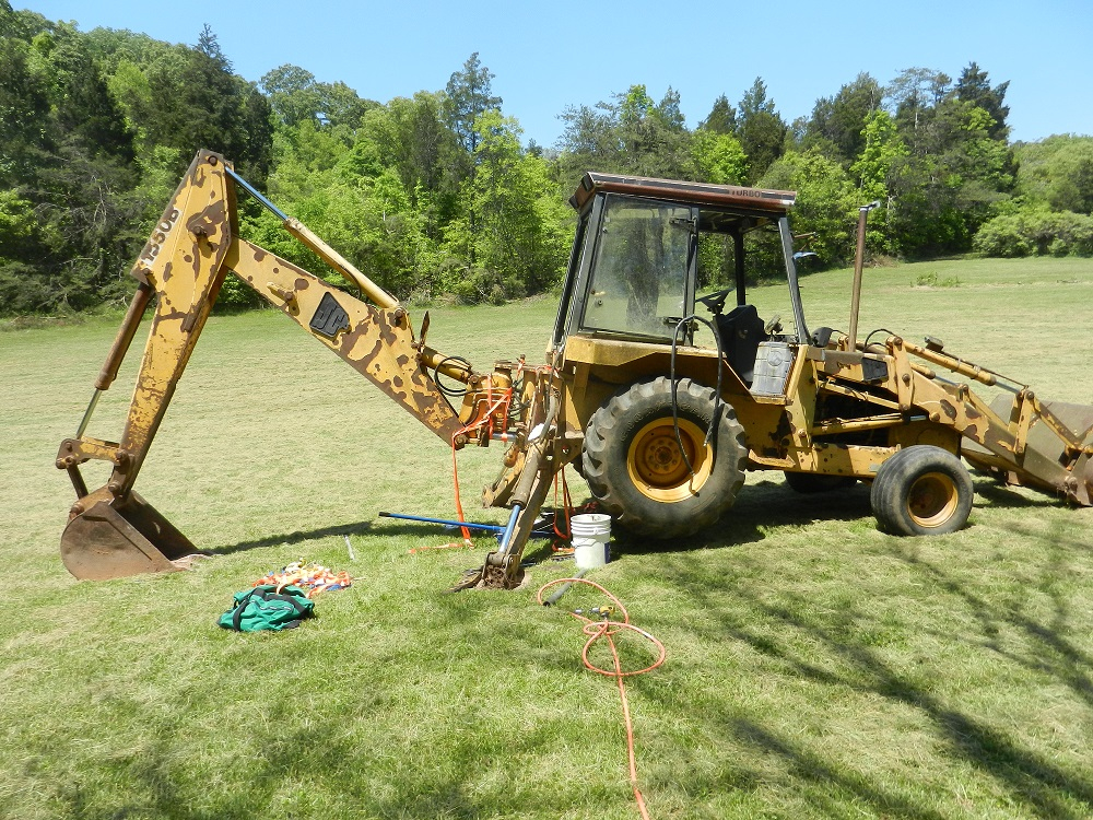

FWIW, I watched my neighbor clear his land off and on for the last 2 years and the best tool he has is the grappler on front of his 33 HP tractor. With it he can easily and efficiently move 10-12' logs of reasonable width (Fir, Maple, Alder in the 18-24" range). That grappler also makes fast work of Himal. BBs in our area. Once the huge masses are removed, the trail mower keeps them at bay. [+ 1 for Crossbow (even though you may not want to use it, which I get).]. I agree with the others who mentioned that a parcel your size is not suited for a tracked rig.
For my part, I cleared trees on my parcel with an excavator. It's what I had at the time and is what I learned on, so I felt comfortable working on my slopes. With the thumb attachment on it, I was able to easily stage log decks for firewood and for log truck runs to the mill. I did a mix of grappling with it as well as cabling. The boom makes it easy-ish to drag logs off of the steeper hillsides to flatter ground. It takes time and a willingness to get creative; I never thought I'd have use of a 8,000 lb. block, but I'll be darned if I didn't...and I'm now pretty good at maneuvering 30' log sections into position. The power and leverage you get from a heavier, tracked machine is a definite plus, especially when you need to drag. For me on 5 acres, Yes. If I had to manage 80, No - not as a main tool. I still see a realistic use case for it, tho.
I was definitely in the camp of towing a trail mower behind my ATV before I bought my current tractor (3-point finish cut mower- I don't do any heavy brush cutting with it). I think it's a decent choice as long as it's heavy enough to do the job in a reasonable time. IDK about you, but my thumb gets sore if I have to throttle to a consistent speed.
I didn't see if anyone else sugg. this, so apologies if I just missed it: Considering your overall budget, get a tractor that you're comfortable with and consider renting or hiring out the the heavy lifting (no pun intended). I understand that rent/hire is not the same as the equity you get from ownership. For instance, I paid a friend of a friend $2200 for some dozer work that I could have done myself with my mini-Ex and my tractor in a month, and it was done-done (right I might add) in a weekend. Renting means you need to be able to plan ahead and keep the commitment, and that does not always work out in life.
