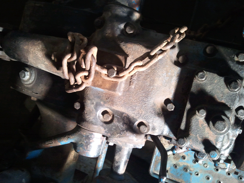

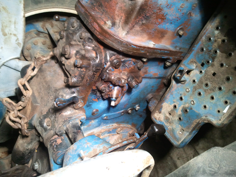

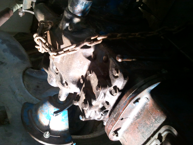

I will plowing the other day and my lift quite working. Pulled it apart and found my return line had snapped in half above the fluid level. I welded it back together but now I cannot get the pump to prime. I have been all over the hydraulic thinking I might have missed something that might of broke but cannot find anything. Does anyone have any suggestions? I am just scratching my head on this one.

Yes I have followed the instructions in the manual to bleed the pump however I am not getting anything out of the hole where the allen screw is
Here are some pics so you can seres what I am seeing would I blow are in the big bolt or the little one in the center?

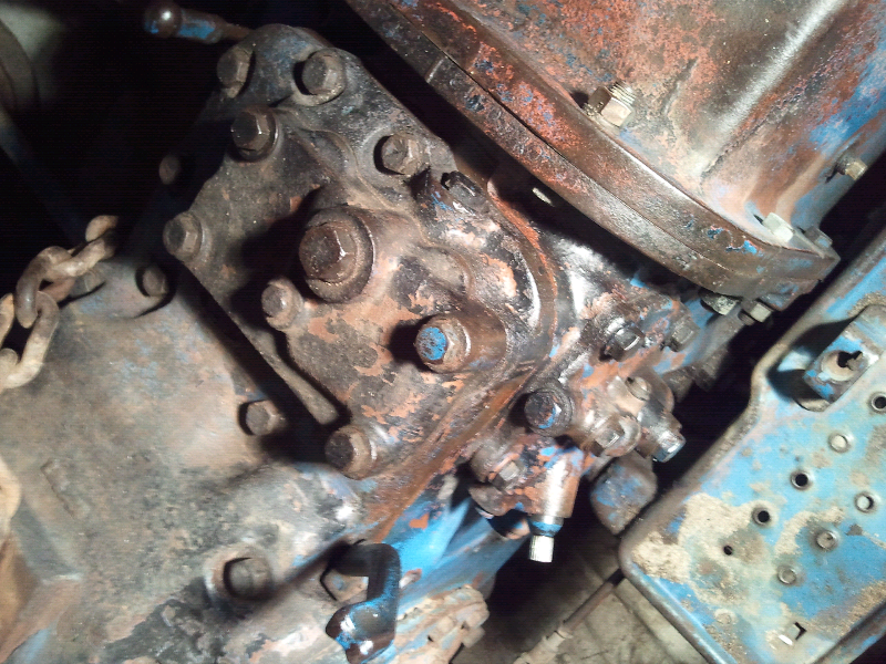

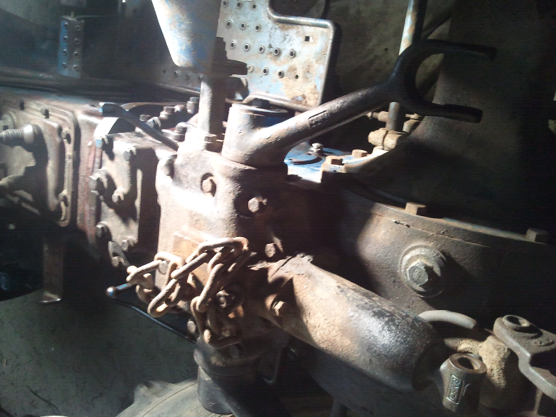

More pics

Thank you everyone for you're help I managed to find the problem. The main line going into the pump had come out just enough to where I could not tell but enough that it was sucking air which would not let the pump prime. Thanks again for the help
