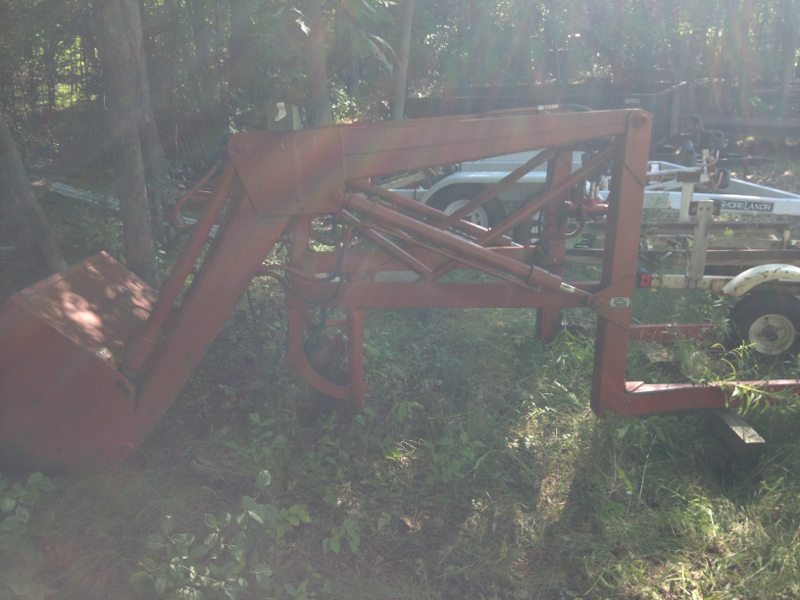

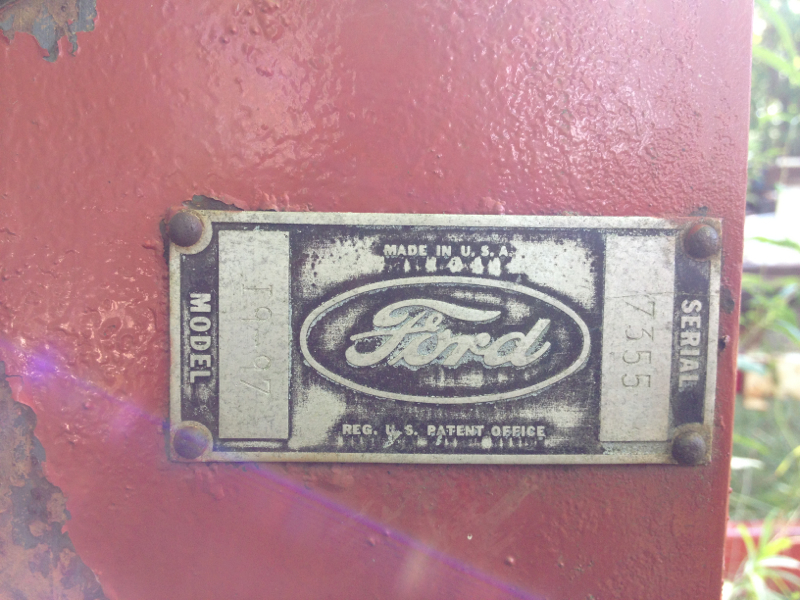

Hello I have been in the market for a Ford Loader to mount on my 68' 2000. I found one but not sure if it will fit. The model number on the tag says I9-97 and the serial number is 7355 I think it might be a 703 or 720 Loader. The tractor this is mounted on is a 50"s ford 861 power master, I believe. The question I have is, will this mount on my 2000??

a dearborn 19-97 is an industrial loader with da lift cyls.. a 105 model was available with sa cyls... it was designed to fit the naa and 6XX/8XX tractors.. kits were available for 8n, ferguson 20/30/35 and oliver 55. IE.. this loader was out BEFORE the 65+ models came out.
will it fit a 65+? with a torch and welder.. I'd guess yes. not with the brackets it's using for a 00 though....
a 730 loader is what would fit your 65+ 3 cyl.

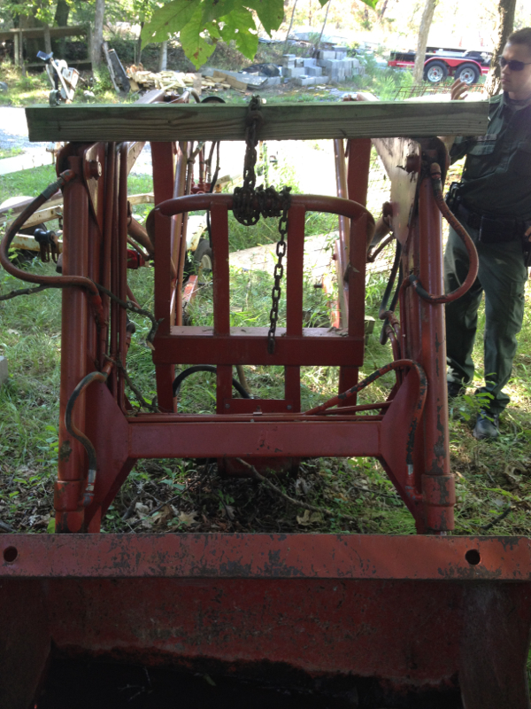

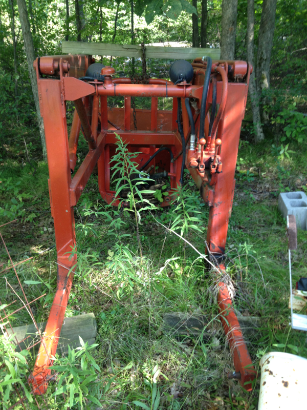

Is dearborn made by ford? Here is a picture of the tag and a couple other photos. I took some rough measurements and everything seems close but it's hard to tell without having the loader right there.

you found it.. but yes.. d/f same deal of that one..
