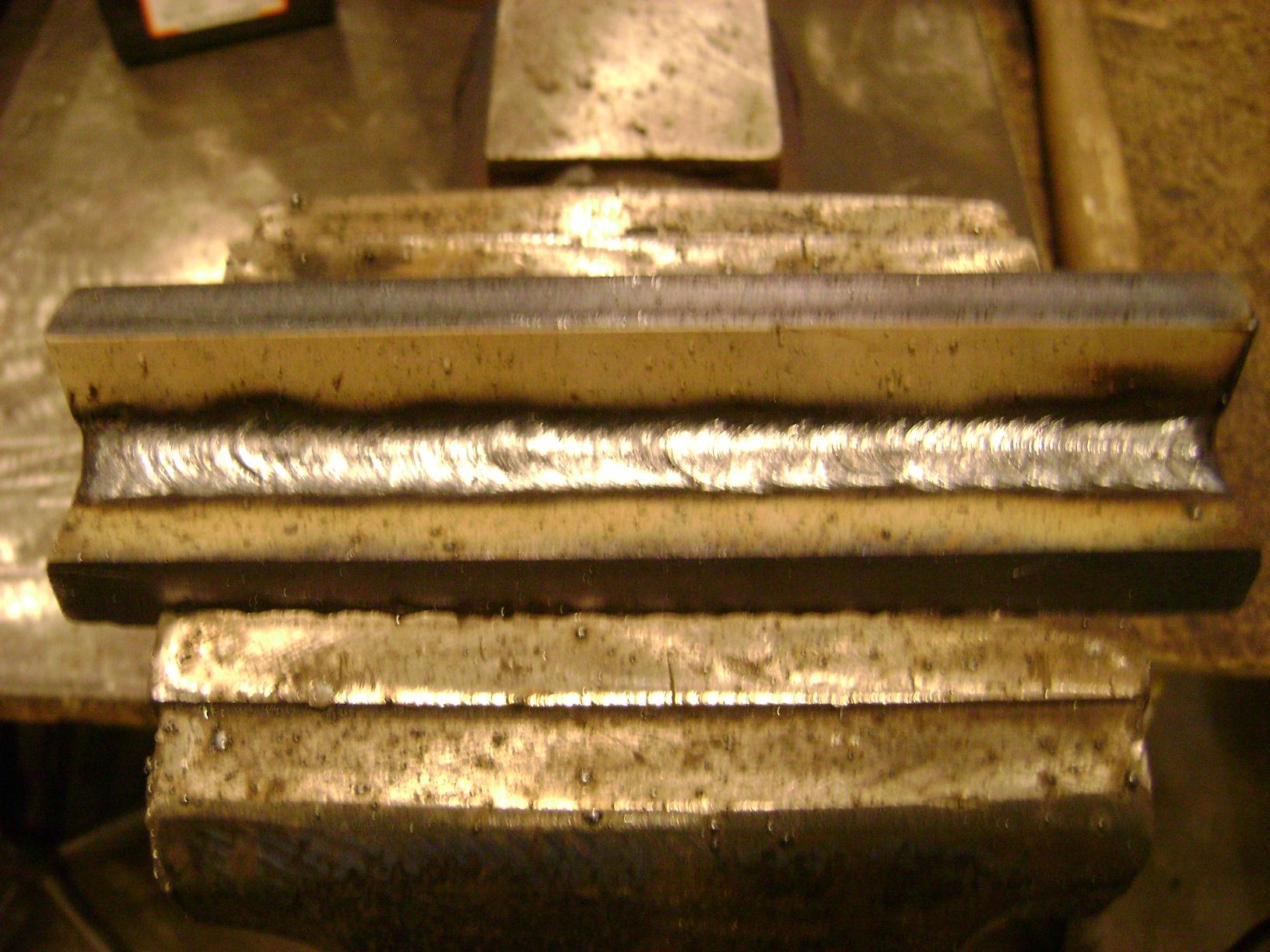

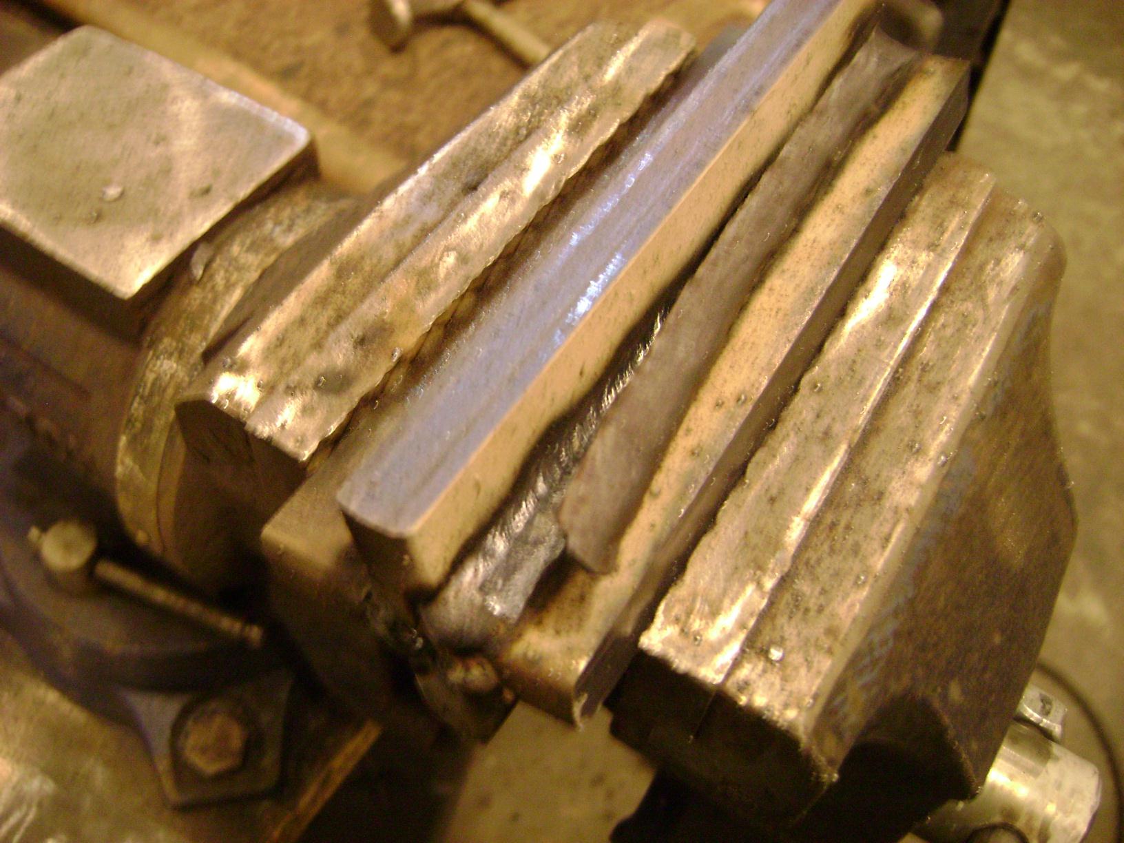

I never heard of 7014 until joining these tractor forums. I played with some.

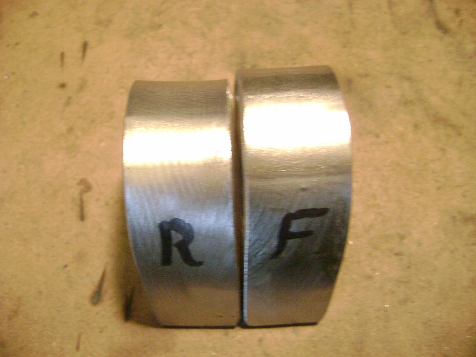

It will pass a bend test, but not so good with an impact test. Broke with only 10-blows of a 4-pound hammer.
