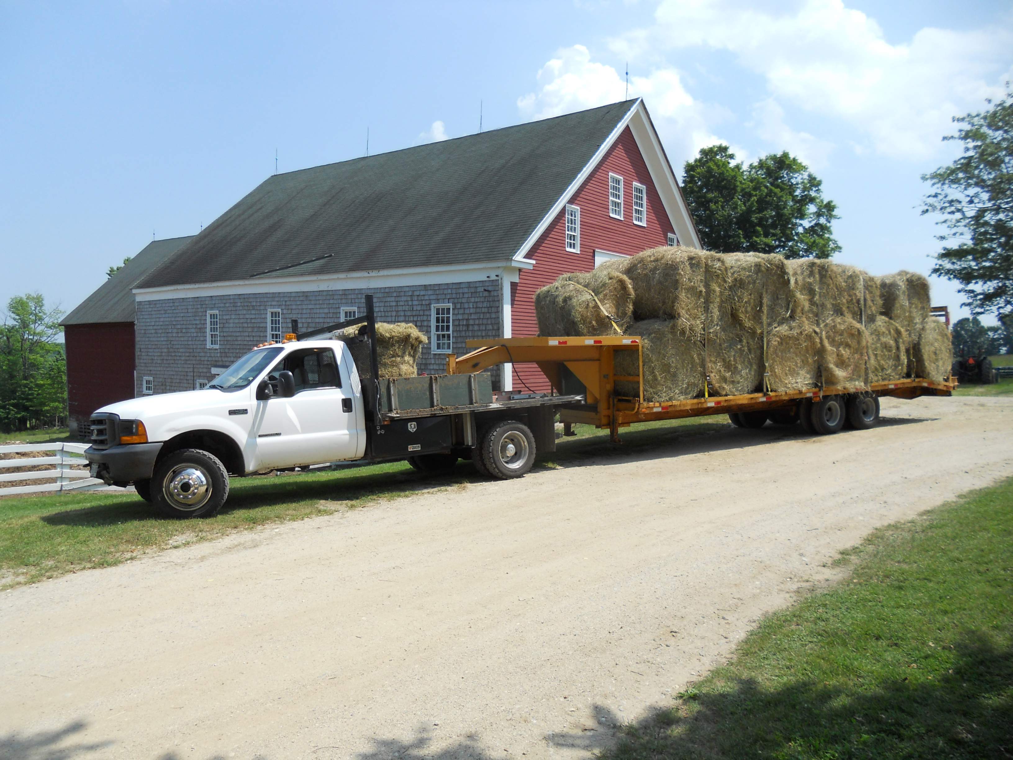

This is my workhorse it has 330,000+ , I have a triple disc torque converter, a transmission cooler out of a 6.0 w/ gauges to monitor temp. and shift kit and cold air intake, 4" exhaust with towing tune and air bags
I tow with it almost every time it leaves the yard, it has been very reliable and gets decent mileage.
I forgot to say it is a 2000 model F250.

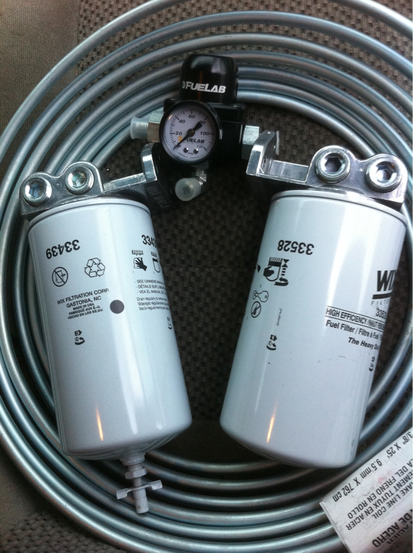

Here is my 01. I put a triple disc TC in it with a lower stall. (in the gravel :( ) Also switched to a IH water pump with ELC coolant. I am gearing up for round two of modifications. Building a steel line regulated return, deleting intake air heater, deleting fuel bowl/heater, deleting EBPV with non ebpv pedestal and cutting butterfly out of exhaust. I will probably throw a Donaldson filter in too. When that's over the wife directed my "phase 3" to put 5" non muffled exhaust, powerstruck chip, and wicked wheel 2 compressor wheel. Unfortunately my truck is PMR positive so until I change rods I am capped right there. I really enjoy working on these trucks and would really like to get auto enginuity for the lap top so I don't have to troubleshoot everything with a meter.
