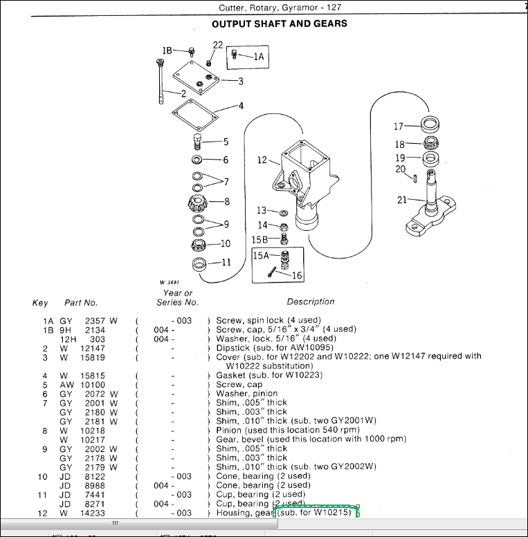

Anyone have any idea how I can find out what brand gearbox is on my brush hog, The only markings I can find is the following number W-10215-W, it is green but don't know if it is original. Bearings are out both front and rear, race's look OK. Would like to rebuild gear box, if I have to replace I think I should buy a new one, however I don't think I will find one built as good as this unit (old). I am having a hard time getting gear box removed as I cannot slide shaft out to get to the nut which holds shaft to blades on top of bottom gear. ave removed retainer ring behind top gear, but still unit hold tight. Help folks!

You might post a picture of it here, and get lucky that someone has one just like it, and knows what it is, or even better, have a spare gearbox on a rusted out hull sitting out back. Verbal discriptions loose something in discribing a rotary mower that a picture explains perfectly.

Welcome to TBN
Sounds as if you have a JD 127 Gyramor Rotary Cutter or other JD with same gearbox.
