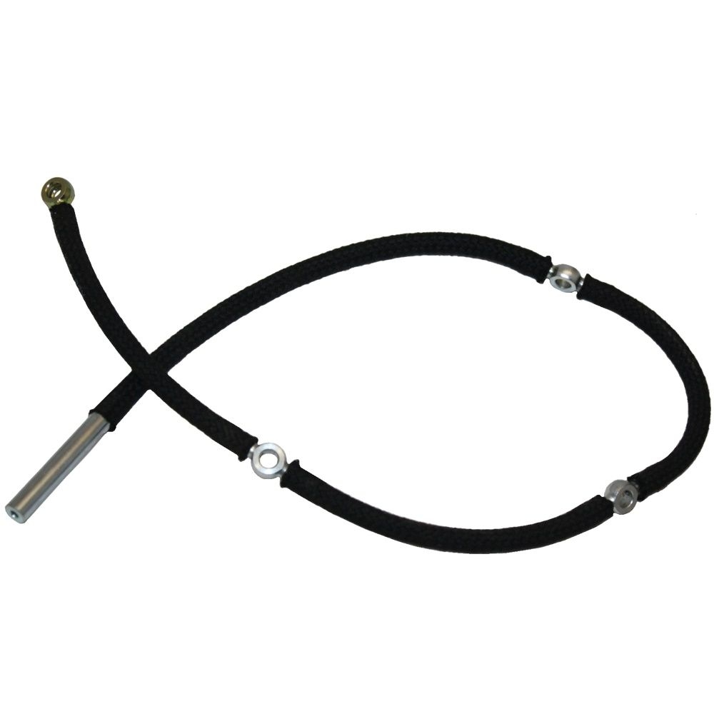

Found real Tubing , its metric , When you take pipe off the shaft theres a small fitting under it :)
Cost me 8$ to fix, almost cost me 250
Found at a volkswagen dealer

Lady on phone tried to take my money without telling me shipping and boarder fee, was missing 5$ on the card, She called me and I said il go put more money on it, then thought frig that im not paying 265$ for a pipe with a few fittings I already have

I found the real piping, the parts guy at kubota dealer told me the IH guy gets the pipe at the volkswagen dealer, its fixed, no clamps needed
