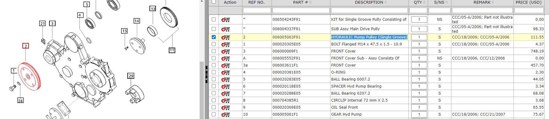

The pulley on the hydraulic pump is cracked - is this the correct replacement?

I ask because the one pictured doesn't look right - no splined hub shown and holes to attach this part look wrong

It looks like you removed the pulley mounting hub in the second photo. The pulley is held on with 4 bolts to the hub. Just take the pulley to your Mahindra dealer. I had mine replaced, when it cracked in warranty, in one day.

Now I am thinking straight. I just remembered I had it all on CD. Look at the smaller window in the diagram. Mine, and looks like yours...........is Exculsive For Extended Camshaft. Item #22 is where the pulley mounts with 4 each item #24. I do remember the bolts are m8.
The * number just above item 2 is the sub assy main drive pulley. As you can see there are 2 groove pulleys and a single grove pulleys. We have the single groove pulley.Hyd. Pump Diagram.jpgHyd. Pump Parts Callout.jpg I think item 22 is what you took off in your second photo and didn't need to do that.
Bottom line, take the old part to a Mahindra dealer. Part numbers have changed numerous times over the years since this CD was made.

Ya I removed the splined hub... this part will need to be attached to the new pulley

You sure about that? My pulley is changed by loosening the belt and removing 4 bolts. That is all.
