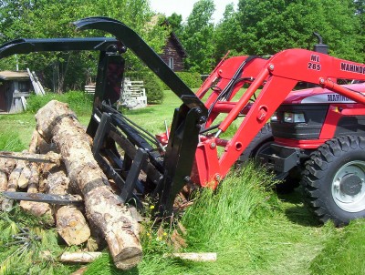

The attached pic shows two things. One - the type of grapple I have. It is very strong. I can lifted a full load of 16' logs, (softwood), and load them for trucking. I use loaded rear R-1's and the rear gets light, but I am not goin' any distance. I don't raise it high until the last moment.
I purchased this type because I thought it would be the versitale for me. I intend to make a work platform that will fit on the forks. The grapple arms will be strong and stable side rails. Another use I envision is to acquire two more forks, (the salvage yard is on watch for me), and with four forks it will make a good brush/whatever, rake and transport. I use it for brush now and it is amazing the amt. I can get on it. As I load I compress the pile periodicly, with the grapple arms.
I have also used it to add lots of material to a burning pile. Each load was like a commando raid. Had to consider the height and width of the fire burning, wind etc. Then raise high make a run toward it, get over the fire, dump it on, and reverse the heck outa' there before I get caught by the enemy/flames. Kinda makes your heart beat a little faster. It is fun to see how large a load I could dump cleanly and still escape unscathed. It really is fun...I mean it!
The second thing the attached pic shows is how mine did come unattached as I was building a burn pile. The reason it got this way is because the operator forgot to put the bolts down to hold things together. I gave him a pretty good talking to. It's kinda funny, he only shows up when something goes wrong...
