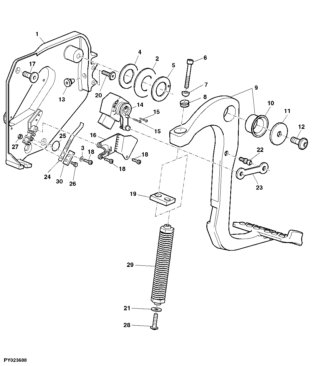

I am trying out a 6430 and the clutch is real touchy. You can't ease out on the clutch its either all or nothing. Is there anyway to adjust these clutches or is it shot.
/ 6430 clutch #2
It appears that the traction clutch is electronically controlled as parts key #14 is a Potentiometer.
/ 6430 clutch #3
Not all std 6430 tractors will have ele controlled clutch pedal linkage, all premium units will have ele control at linkage. Either way, wet clucth system for both units very low failure rate. Most likely these settings are dealer controlled via programming.
