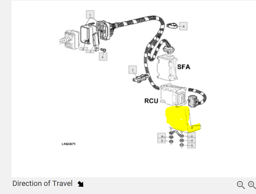

Where is the RCU located? (cab Tractor)
looking at schematic in book but I still can't figure out where it is. Is it in the compartment to the left and behind operators seat?
Think I have a wiring issue but I'm not sure
/ 6410 RCU code 57 #2
Looking in JD parts, it looks like it is on one of the fenders (hard to tell)I am guessing left? I highlighted in yellow, what "might" be the fender?
Both the RCU and the SFA control units have 18 pin connectors, a center retaining screw and 9 terminals on each side of the pin. To help ID the RCU, it uses 16 of the 18 terminals, the SFA uses 13 of the 18 terminals.

/ 6410 RCU code 57
what is the SFA, do all tractors have it?
in a compartment behind the seat on left side is a box with large connector. also in same place is a 18 pin connector not hooked to anything
/ 6410 RCU code 57 #5
Suspended Front Axle control unit. No, all tractors do not have it.
/ 6410 RCU code 57 #6
Does the number of wires match what I posted in post #2?
