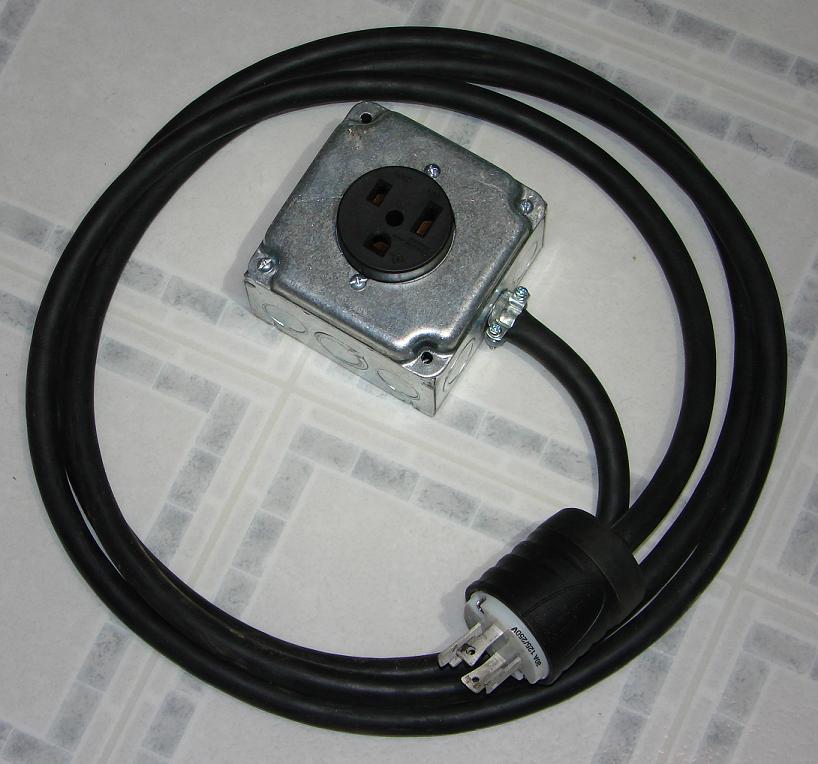

I have a 5550 watt generator with a 8550 surge that has a 120/240 volt 30 amp receptacle. With the advice of some fine folks on this website, I was able to construct a 50 amp box with a cord that has a 30 amp connector attached. See the pic below. This setup allowed me to begin learning how to weld. I now have power in my barn but before that, the generator was my only source of welding power. I have a Lincoln AC225. Although not intended for that kind of use and the 30amp breaker trips from time to time with continuous welding, it still works with low amp welding or very quick welding tasks. It's very handy in a pinch when you're out in the field and you need portable welding power.
This is my experience as well. I have a Coleman 4kW. It will power my 220A stick welder for light stuf but leaves you wanting more. If you can get the full 30Amps that should be available from a 6.3kW continuous you should able to power 1/8" 6011 rods quite well.
