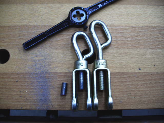

Okay so that explains the 2 different yokes, thanks. I think I am going to extend the threads on mine to get more height.
VP
   / 62D mower on 2320 wont cut higher than 3"
#38
I just tweaked my yokes! (it was fun). I will gain 3/4" in cutting height so now my height knob will be more realistic, H will now mean 3/4" higher. I cut them and threaded them by hand, it took a while but will be worth it. You can see the before and after in the photo. I am going to install them and level the deck (again) and see how it goes.
VP
#39
Success! My height now is 2 1/2" at the center M knob position and 4" at the H postion. I still need the adjustable 3PH link so I can get the small amount of height so I can fully spin the knob. The clearance to the frame is 1/2" no, not the 1/16" factory spec but pefectly acceptable. My deck is now high enough for transport without it needlessly being too low like it was stock. I do have to make sure that I still have clearance with the erroneous offset in the left hand lifting arm, I think I will wrap the hydraulic line with rubber and electrical tape for a safety buffer. You would think John Deere could have figured this out themselves, shame on them.
VP
#40
Update, my ideal 2 1/2" knob setting has been "Promoted" up a couple notches. Even though I added as much thread as possible to the yoke link, I had to back off some of the threads so the arms will drop low enough for the deck to rest on the ground for installation. But I did get an improvement.
