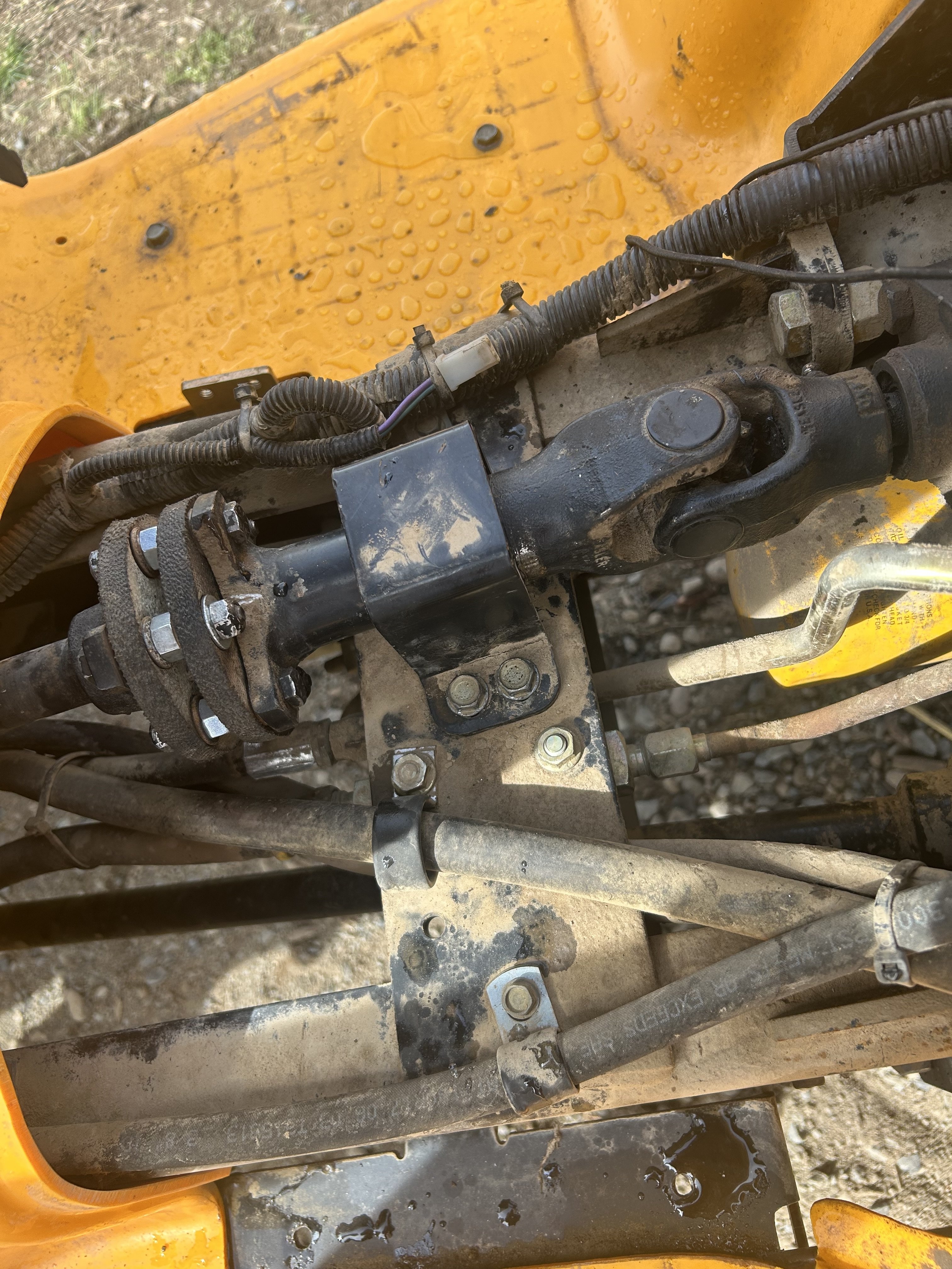

My 05 cc started vibrating with increased throttle a couple years ago. I had a stroke a while back and wasn’t able to crawl under it to see what was happening. It got bad enough that I figured I better see what’s up before something came out the floor. They use a rag shaft that uses odd little washers for no reason I can’t figure out and the spline attachment to the transmission isn’t using the whole spline. The yoke was loose and wobbling on the shaft. A new driveshaft is $650. Evidently alignment is achieved by tightening the 6 bolts with their associated spacers and washers evenly. What a joke. I’m selling it and getting a Kubota.

I kind of fixed it temporarily. Time to sell!
