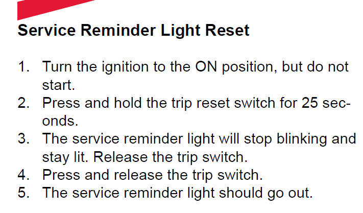

I have a 6065 and have looked in all three fuse boxes and cannot find a label called reset. Also my battery indicator does not come on either. anyone else in this same situation or have a solution?
Have you found a solution??? We have the same problem on ours as our fuses don't have any one of them labeled as reset
   / 6065 reset service minder? #16
If you don't have a reset fuse, try the attached procedure. I have a 2023 6075 cab and this worked.
   / 6065 reset service minder? #17
I can confirm the simple reset hold for 25 secs procedure works. Thank you all.
