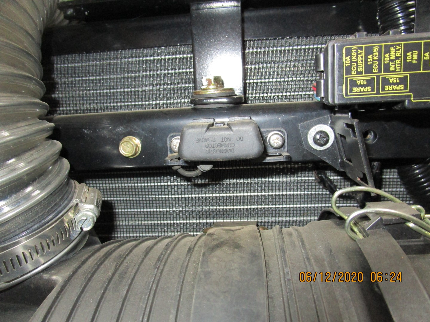

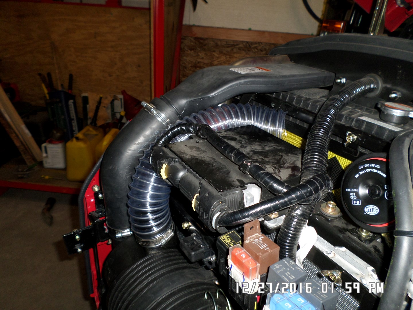

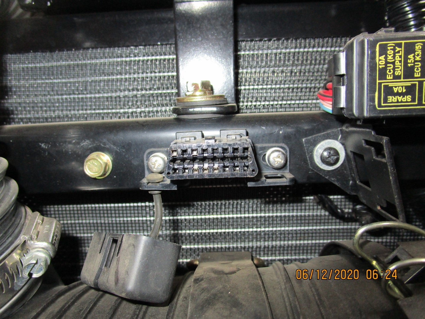

While I do not own a 6065 [ yet ], the photo below shows you what your OBDII probably looks like. Everything being black makes it hard to find stuff, but you port is probably located in the general area of your engine computer, like my 2555. It probably has a black cover on it, like mine, that also makes it hard to find. In the below photo, the computer is mounted horizontally at the top in front of the radiator. The OBDII port is covered and facing forward just above the Donaldson air cleaner.... right below the computer. I know you can reset engine codes via the OBDII, but I do not know a boot service reminders. Good luck, Jerry... :) [ I do my own servicing, too... better me than some young kid ]
added some close up pictures....

I have a 2021 6075 Cabbed. It has a courtesy light on the lower left side of the dash housing. My OBD port is accessed by removing that cover over the light.
/ 6065 reset service minder? #7

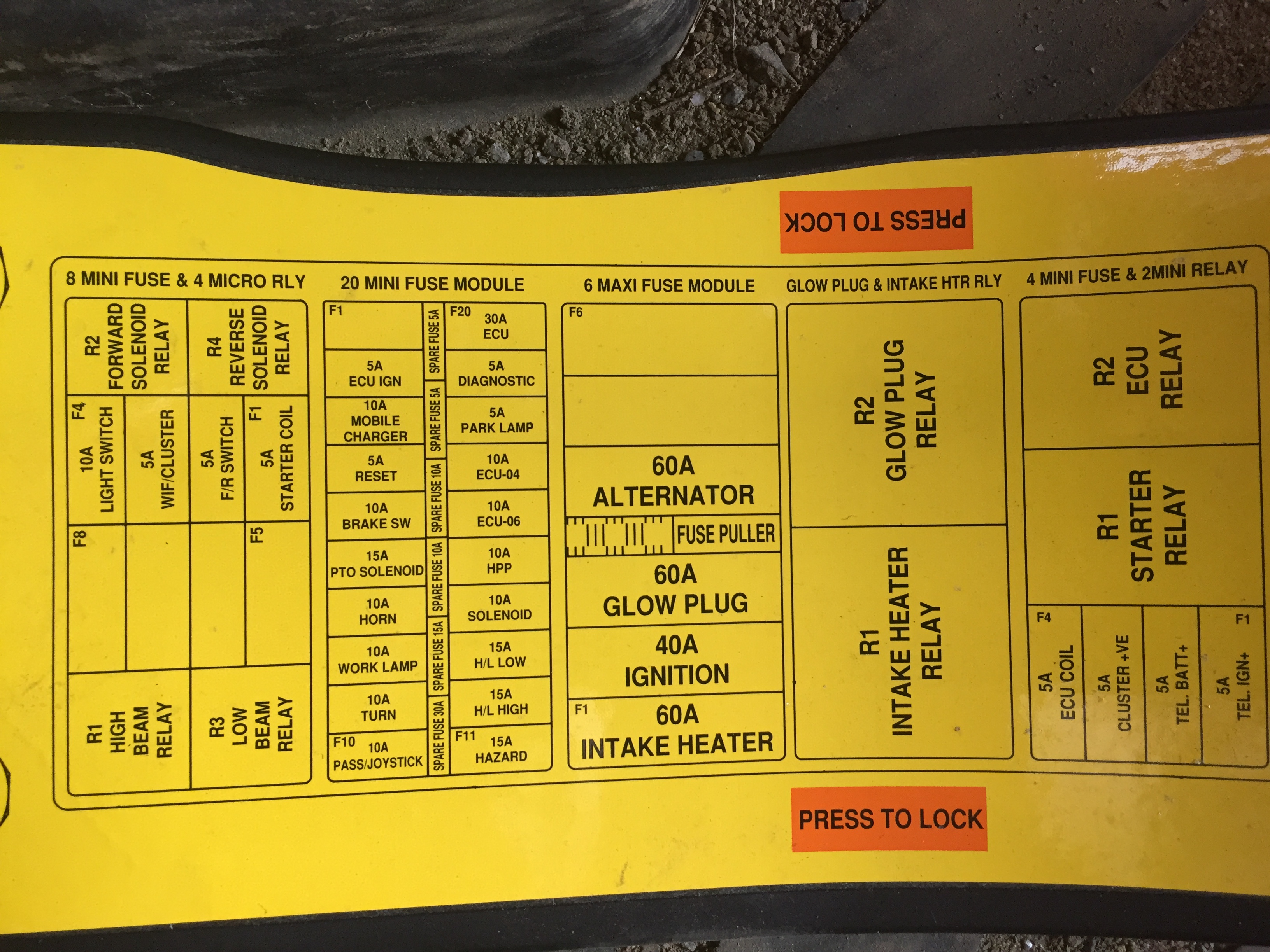

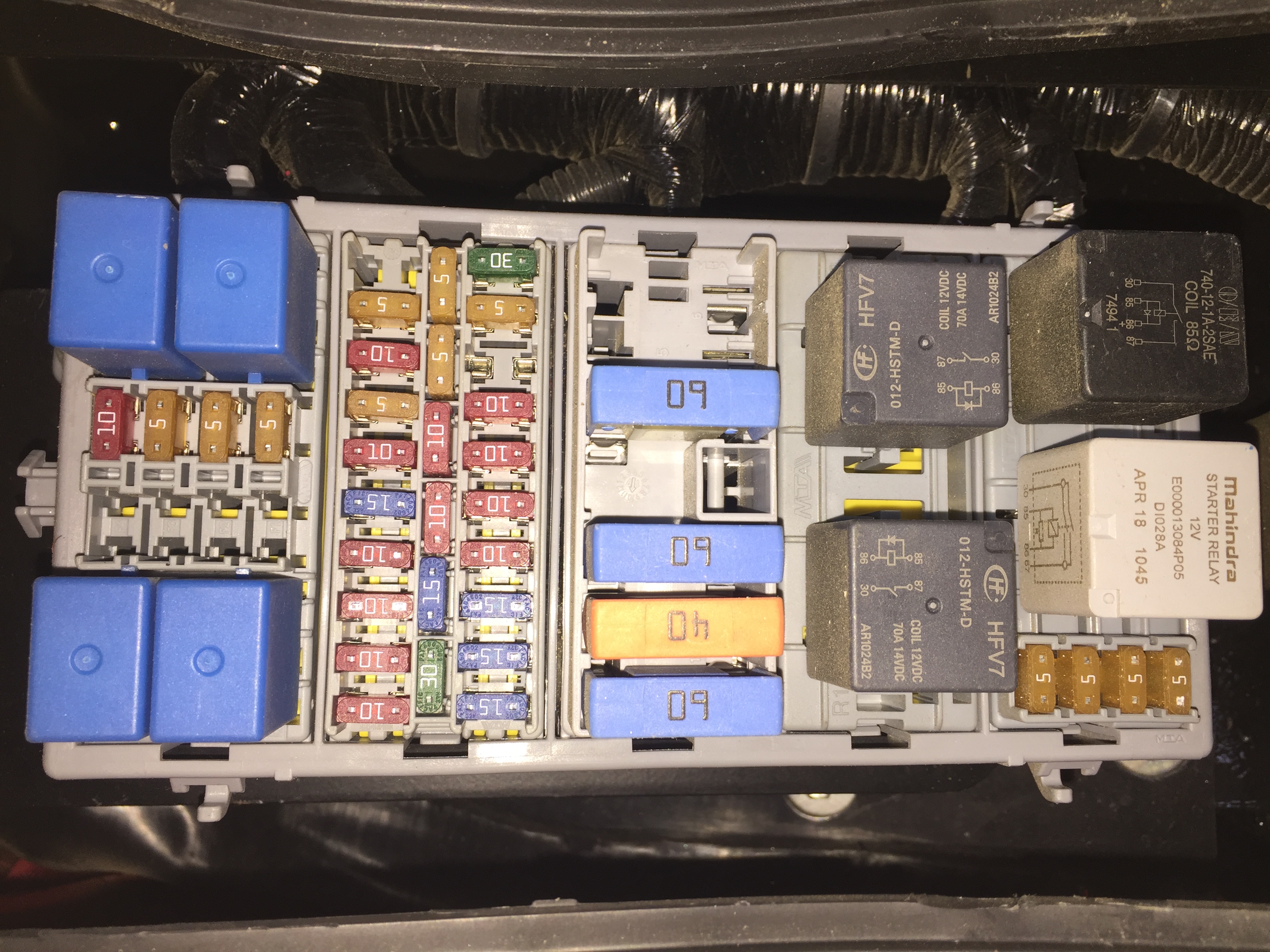

I have a 6065 and have looked in all three fuse boxes and cannot find a label called reset. Also my battery indicator does not come on either. anyone else in this same situation or have a solution?

GM,
This thread talks about the OBDll connector on the 6065. I'm not certain if the two tractors are similar, but the OBDll connector on the 6075 open station is centered under the seat. The connector is facing forward and requires no tools to access.
I'm curious if your OBD2 reader will read the Mahindra and what you intend to do with OBD access?
Have you found a solution??? We have the same problem on ours as our fuses don't have any one of them labeled as reset
