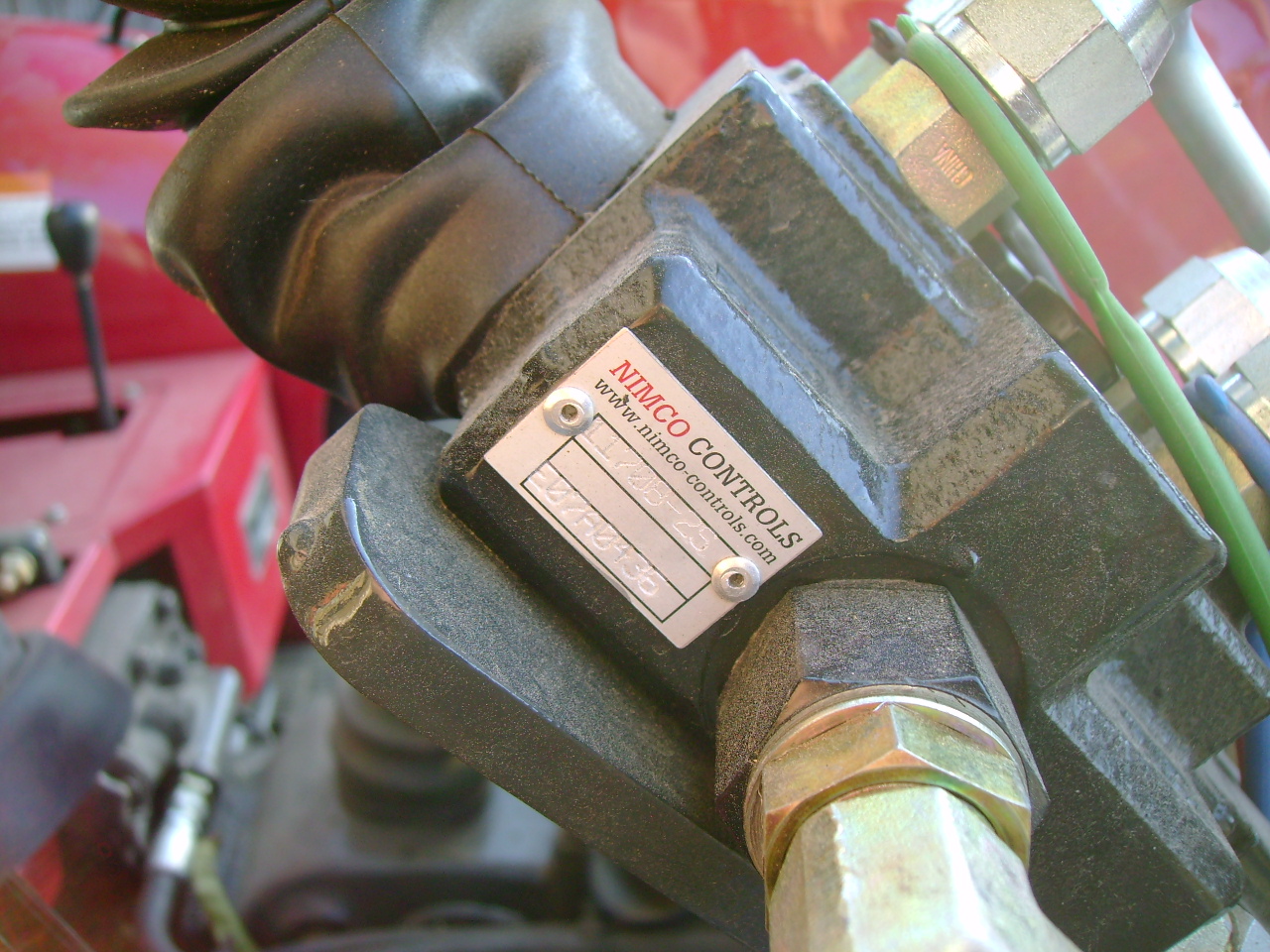

/ 6025 Owners? #4
BDW,
Do you have the Nimco Controls #11708-2S control valve on your loader? That is the model number of the valve on my ML230 loader on my 3525...
I can lift/dump or lower/curl at the same time fairly easily with mine... it took a bit to find the "sweet spot", but now that I've got a few hours of experience with it, I don't even have to search for the right spot, I find myself doing it automatically without even thinking about it.
/ 6025 Owners?
I will have to look and see if the controls are Nimco or not. I hope that there is a sweet spot, I just know that it is not like the loaders I have used in the past. I'll check and let you know, I may just need more time behind these controls to get used to them, I'll keep you posted,
Thanks
