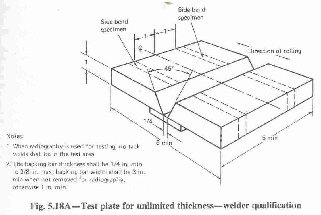

Here's a couple AWS plate tests. I've been told the side bend is the hardest to pass.
