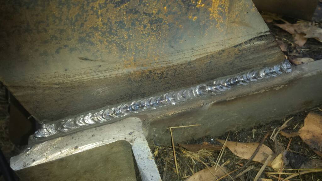

Guys I bought some 6011s to use on less than perfect joints I've got and I feel like it's running super cold any thought. This is at 120 amps electrode positive it's very cold looking and **** to start.
/ 6011 help #2
What welder are you using? Some welders just don't have the voltage to run 6010, or 6011 very well.

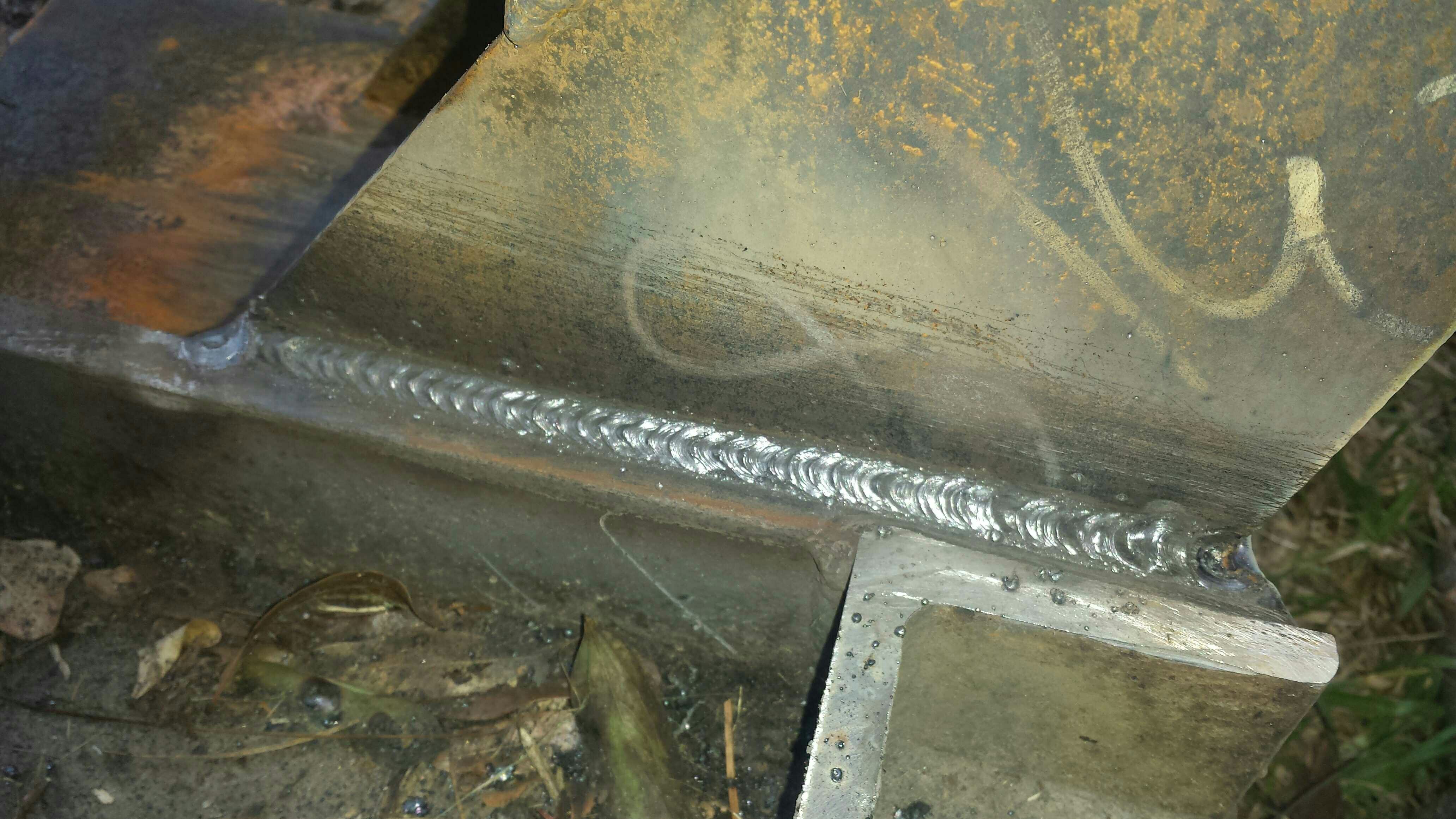

It did a little better on the other side I slowed down on my pauses and let it burn in more.
/ 6011 help #5
That looks pretty darn good! I like Hobart's 335A 6011. It seems to stack real well for me.
