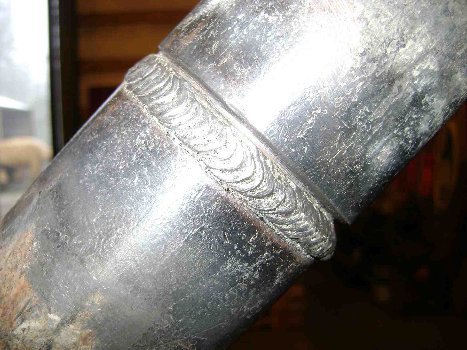

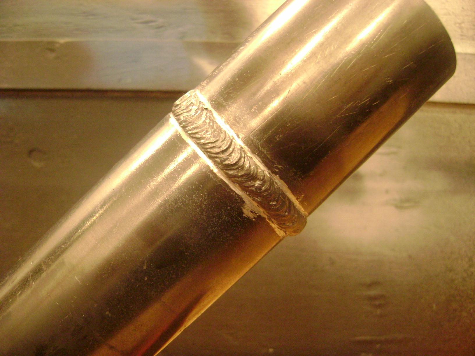

6011 Break test.
/ 6011 Break test. #2
That is basically the only rod I use (I layed my first bead with it) I am going to try to work afterschool with our tombstone to try and get a weld as good as that. (that will take a while, I normaly can bread my welds with 3 or 4 blows with a 2 pound hammer)
/ 6011 Break test.
I like these welds better, but they are 6010.

/ 6011 Break test. #4
6010 is only for dc, right?
