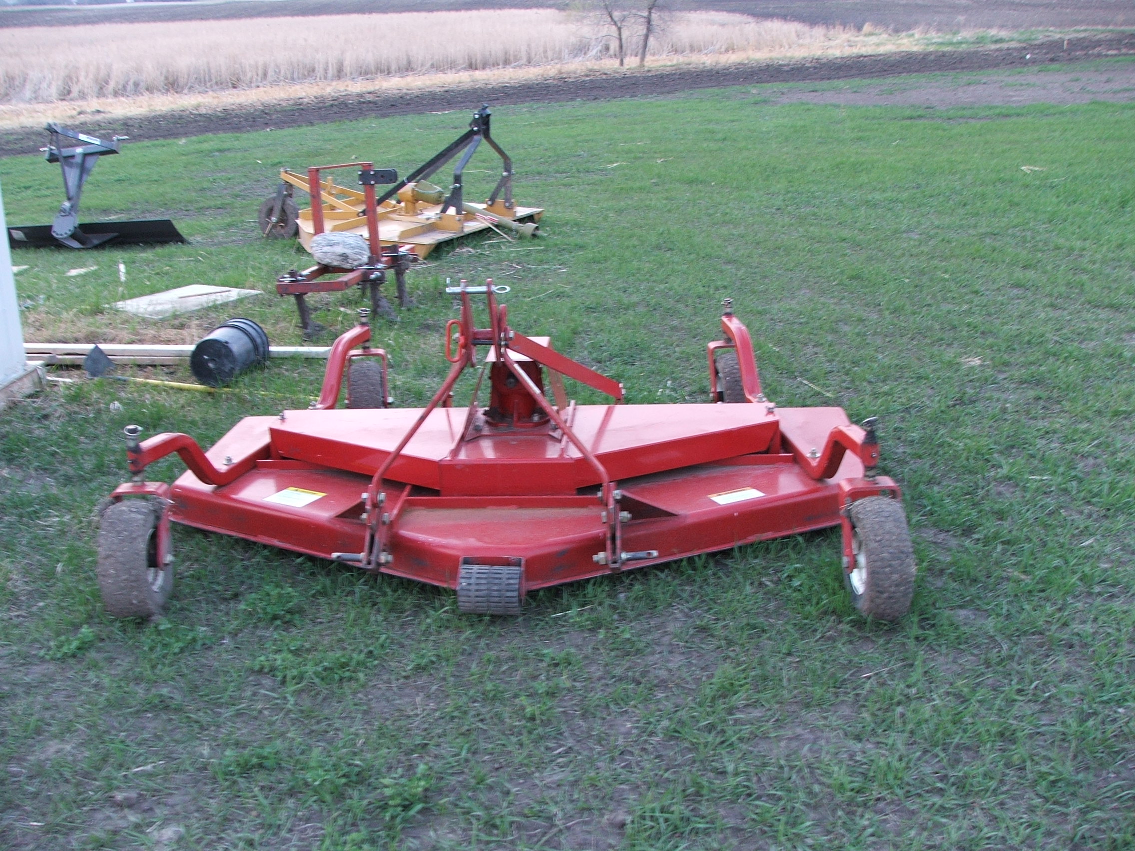

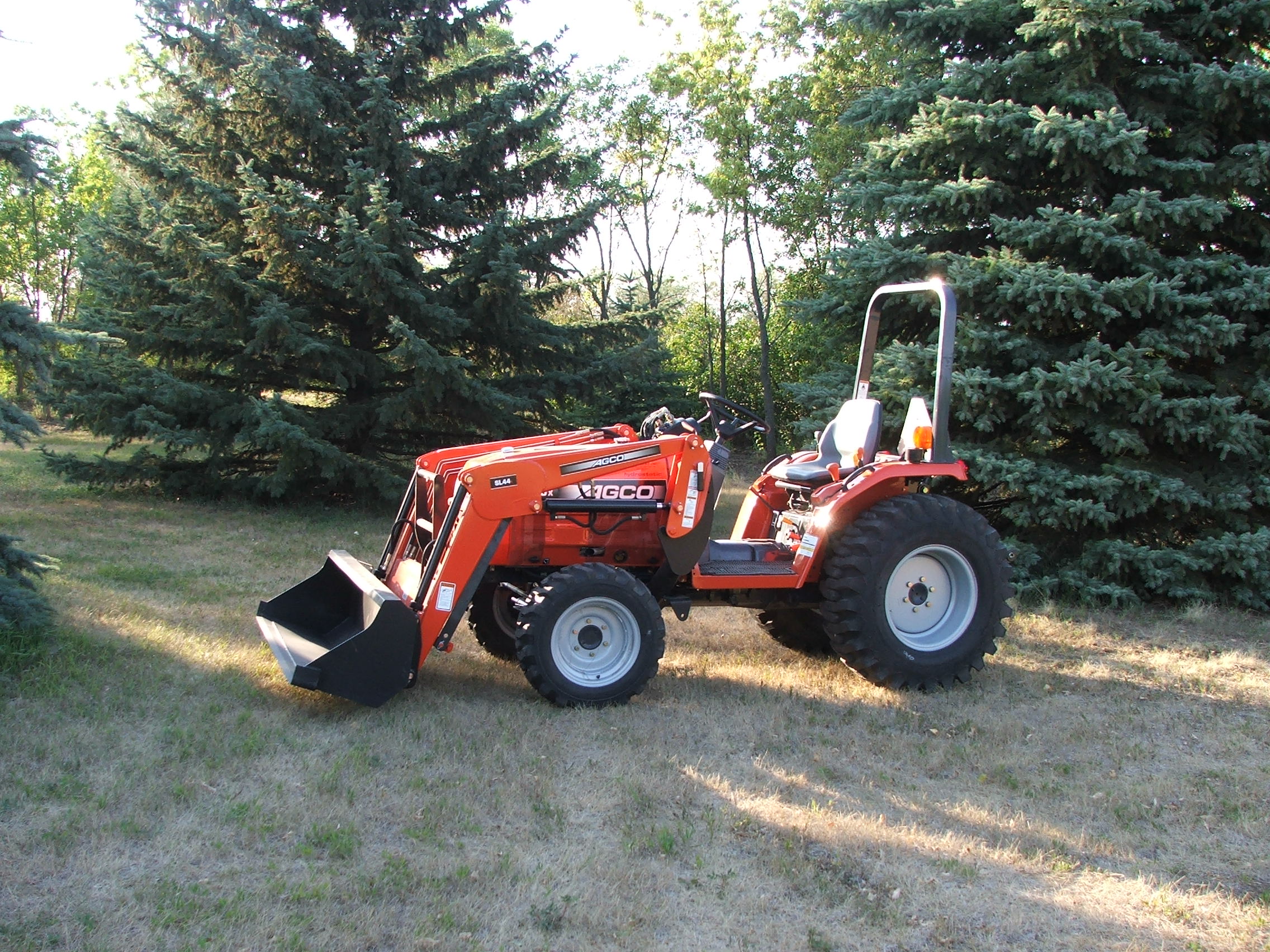

I have a Agco St30x which has about 28.5 engine horsepower. I use a 84" finish mower behind it and do not have any issue with horsepower. but I only use it only on the lawn grass, I have a rotary brush mower for the longer stuff. and my wife usually drives behind me in a smaller riding mower that goes around the tree's. it is hard to go around anything but it does the open area's very fast. My vote would be for a 72" heck you can buy a 60" mower on them piles of junk at home depot.
