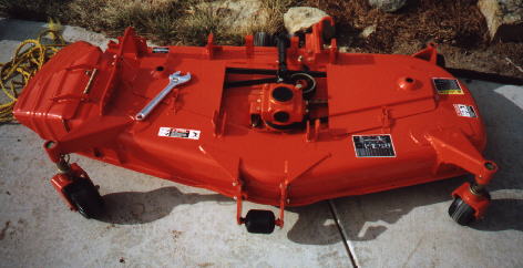

I know there has been some previous discussion about anti-scalp rollers melting if they are used to bear the weight of the mower for extended periods. I have some steep ground that I mow and need to keep the rollers down to do a better more even job of mowing.
I wonder if anyone else has a similar problem and also wonder if there are any type of replacement wheels available that can be greased or that might have sealed bearings that will stand more punishment than the standard anti-scalp rollers.

Scalp rollers on the 60 " are used so the deck does not contact the ground. Book says adjust then so they are at least 1/2 inch from a level surface. I have a BX2200 and cut at 3". On this BX the deck is completely supported by the tractor. In other words, the wheels (rollers) on the deck should not drag on the ground. They are on there just to touch the ground if for some reason the deck drops down like if you dropped a tractor wheel in a hole... They are adjustable and when you remove the deck you turn them sideways lower the deck unhook the drive shaft and lift pins and the deck just rolls out from under the tractor like a giant skate board.
I am sure you have seen the MMM with big swivel (dolly type)wheels on all 4 corners of the deck. These types of decks actually roll on the ground with the wheels and basically the tractor just drags the mower around. There is also a front center scalp roller on the deck that is not adjustable...

Hogkeeper, it is not needed to lift the front end with the FEL on the BX to remove the MMM. I have done it many--many--many-many-times. On the 2410 it is almost mandatory though I have managed it by driving the front wheels up onto a set of bricks. Most of the time my FEL is in the garage--I mount it --I use it --and then I remove it. I have almost decide that the 2410 FEL removes faster than the BX FEL, to bad the same cannot be said for the MMM.
Anti scalp rollers are the plastic wheels and rubber center roller on the BX SUSPENDED type deck. These when adjusted properly skim along about 0.5 inches above the ground only contacting when there is a bump etc. The ground contact type have larger rubber wheels with bearings and they carry the weight of the deck--an entirely different system and in my opinion inferior to the suspended type. Here is a pic of my B2410's ground contact MMM. Note both rubber castor wheels and anti-scalping rollers and wheels. J
