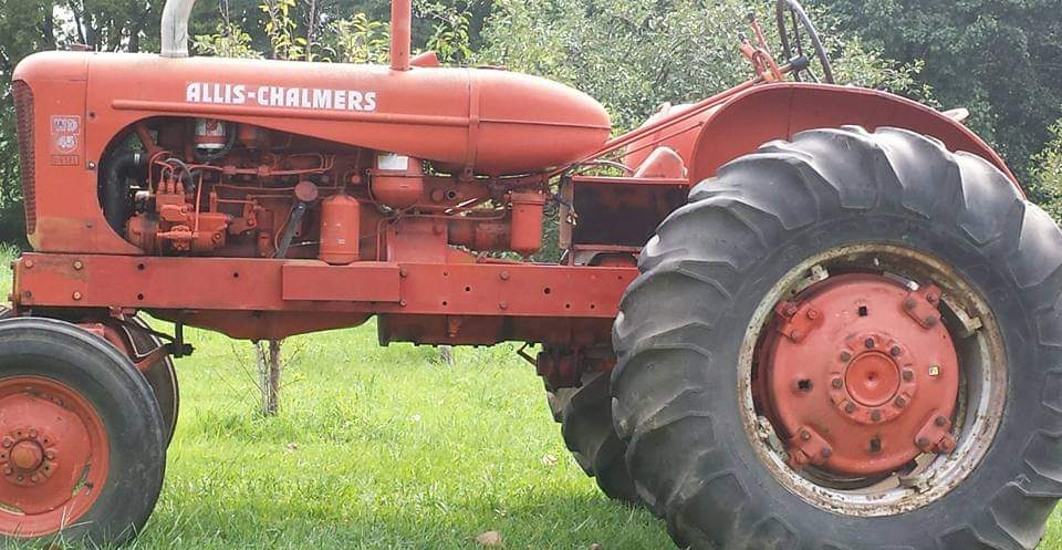

There's one additional thing he didn't take into consideration. I said max speed in first gear was 2.4 mph. He said range of recommended working speed was 1-1.5 mph. The main working range of the WD45 was about middle of the quadrant, which would put 1st gear running speed at that range as approximately 1.2 mph, essentially in the middle of the working range he stated.
Yep. I run my Ford at just above half throttle when tilling.
